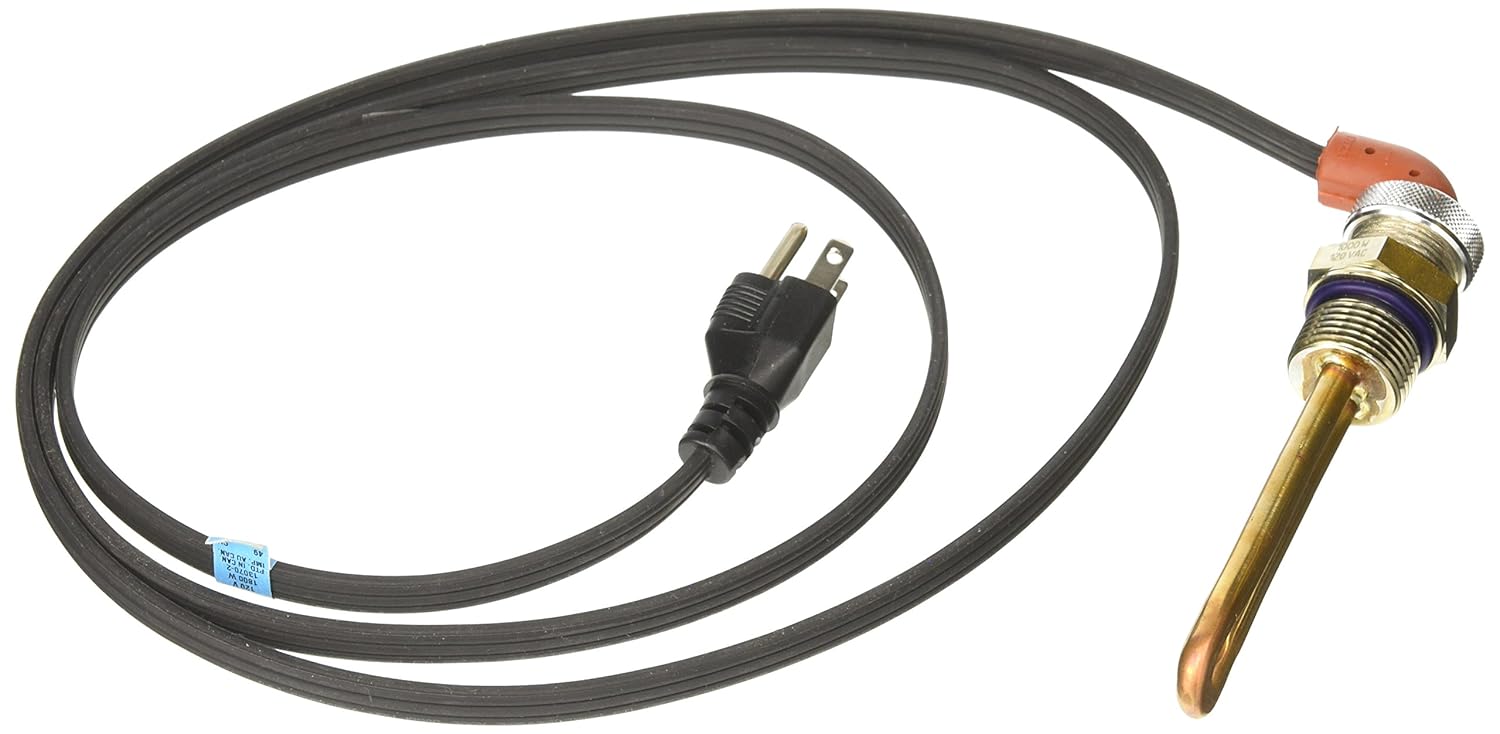

Anyone looked at these that have a heater directly in the oil?
https://www.ebay.com/itm/GM-6-2-6-5-...-/110630592075
https://www.amazon.com/gp/product/B002UNKA0A/

Originally Posted by rv8ch View Post
Heat flux too high and cooks the oil in contact with the element. Oil is a very poor heat transfer medium.
Kats have a lot of different sizes. Looks like no direct sales anymore, look in the catalog for sizes/instructions.
That is for heating the coolant, not the oil. They are normally mounted through a freeze plug. The fancy ones we started using a few years ago in our big diesels will heat, and circulate the coolant.
