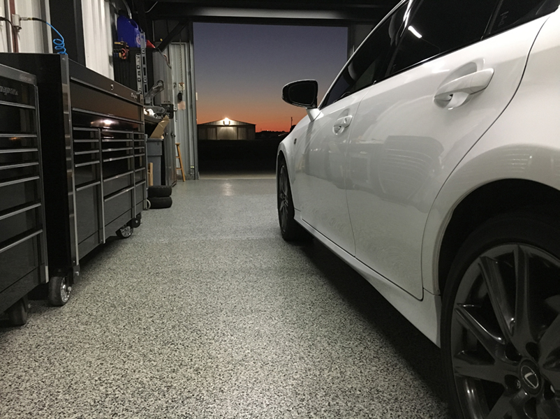

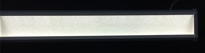

I recently installed some Eaton LED lights and am happy with the results. They are available in several color temps all rated CRI ≤ 85. Another big factor that changes the quality of the light with LED's is the diffusion. These have a beaded glass face that make a nice soft light. I chose 5000K since that is closest to daylight and I hate yellowish light in a work area. Higher CRI fixtures wont have the blue cast at 5000K that lower CRI does.

Michael - that is a very nice installation with a high end product. I have done a few similar, low ceiling, hangar/garage applications, where the client had the budget, but most folks don't want to spend that kind of coin, especially in a traditional hangar.
You did well and I have no doubt are happy with it.
Very good points about lensing and glare control with LED. The "waveguide" technology was invented in Europe many years ago for the smaller diameter T5 Fluorescent technology to control glare and provide photometric performance. It has had a huge rebirth with LED but it is expensive technology still.
