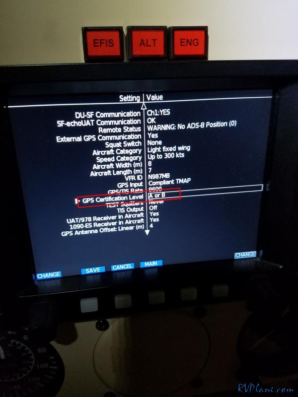

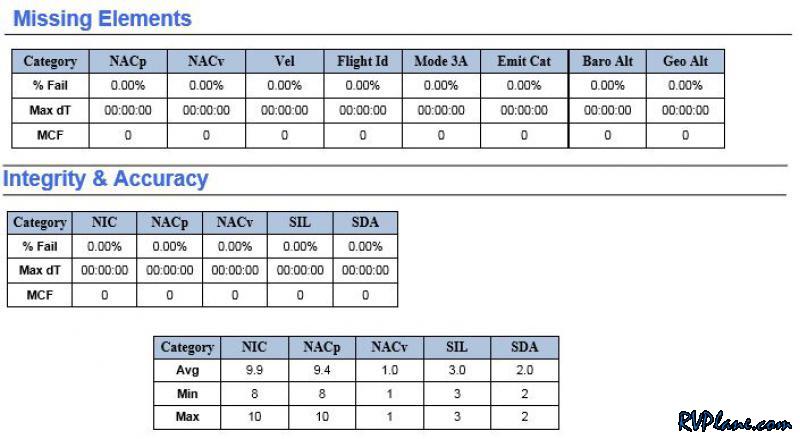

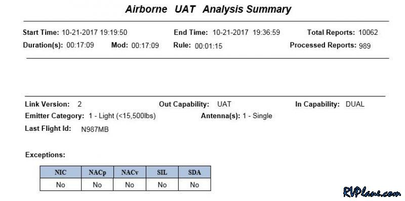

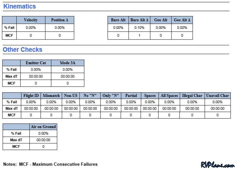

Default uAvionix EchoUAT + SportSX
I installed the EchoUAT with the GRT Sport SX EFIS. It took a while to get the settings right, but all works fabulously!! I couldn't be happier. I am using the transponder "sniffing" feature with a GTX-327, so the RV-12 performance should be the same.
And the FAA Compliance Results
Full write-up and more details:
http://rvplane.com/?categoryid=10000&dayid=1373
http://rvplane.com/?categoryid=10000&dayid=1375
http://rvplane.com/?categoryid=10000&dayid=1378 (lower Part of writeup)
