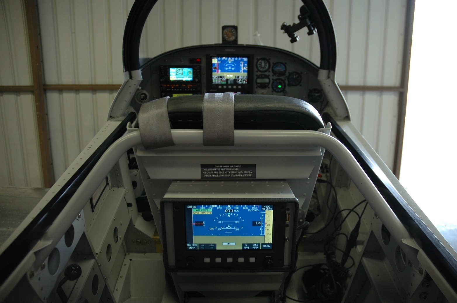

Here is my solution. If you want I could post a better picture.

Think about head and face impact back there. Strictly opinion, but...
The iPad doesn't look to bad, and gets better if the mount is easily collapsed; no struts please. The standard EFIS appears to put the knobs in just the right place for eye damage as the head swings forward and down. The riveted aluminum box looks like a face smasher. It's just too close for the belts to be an effective restraint.

Here's what I have. NO problems as far as knees getting in and out of the back seat, but I definitely include avoiding the knobs of the G3x during ingress briefing. My passengers have all unequivocally stated how much they like having the information back there and with the G3x, the pilot-passengers really have the ability to do a lot.
