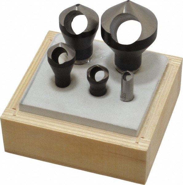

These work great and never chatter:

Old 10-04-2017, 06:22 AM
Join Date: May 2006
Location: Pocahontas MS
Posts: 3,884
Listen to Snopercod....
+1 +1 Just don't use them on fiberglass - even once.

+2. I got the little one from Cleaveland. Wasn't a fan using it in the drill press or by hand. But a cheapie electric screwdriver from lowes is the perfect speeed, 2 turns and done. Press was too fast to cut well.

I like those for deburring as well. However, from my experience, they require much less pressure than the other deburr bits. Too much pressure/turns and the hole will be countersunk instead of deburred.

Offset handle to turn it is all you need. Power will almost always cut too much with any of the bits.
