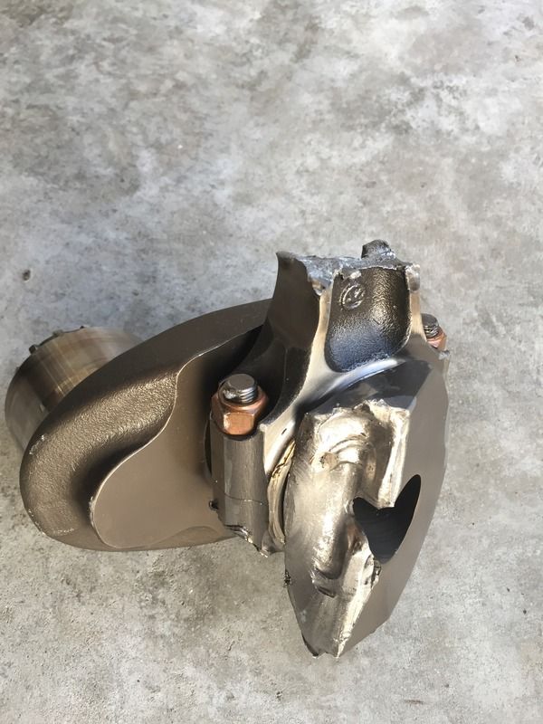

New ECI IO-371 engine with less than 500 hours. Crankshaft is in 2 pieces and one counterweight is no longer attached to it. Either the crank broke first or the counterweight flange on the crank broke first----#4 rod is in 2 pieces (I am guessing it broke after the crank). ECI doesn't seem to care what failed and why.

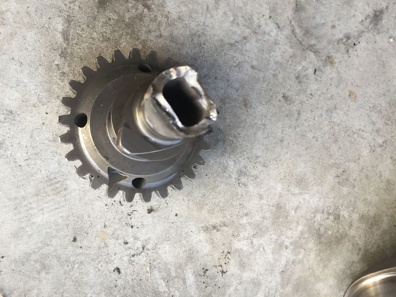

Old 09-23-2017, 08:00 PM
strahler13's Avatar
strahler13 strahler13 is offline
Posts: 402
Default Here's your photos Dan
Cam shaft
Crank counter balancers. Possible initial failure point?

  #40
Old 09-23-2017, 08:09 PM
strahler13's Avatar
Posts: 402
Crankshaft and connecting rod
Part of rear case.
