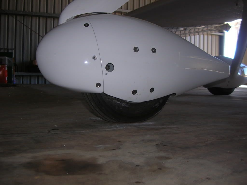

Hi All,
While moving the 7a on grass the front portion of the nose wheel pant literally ripped while traveling over some less than smooth terrain.
Any common sense advice on how to avoid this situation?
Does anyone have an extra front wheel pant they want to sell? 😉
Are all Tricycle nose gear fairings for the RV 6, 7, 8 and 9 the same?
Any and all help is genuinely appreciated.

There are a couple of different fairings out there. Van's, Sam James', etc.
But the big thing is ground clearance, which can be set by the builder when s/he is installing the wheel pants. Installing the pants a half inch higher or lower than the plans call for is a big difference relative to clearance from the ground.

If the grass field isn't extremely smooth and the wheel rolls into a slight depression, all of a sudden, the weight and forward momentum is being carried by the bottom surface of the fairing, rather than the rolling wheel. This can result in a cracked fairing or much, much worse. Think of a pole vault. The bar sticks in "the box", the pole (front gear leg) bends, and if really over stressed, breaks. This usually results in a prop strike followed by a full nose over. Cut your wheel fairing higher, know the condition of the field you're landing on, or stay off the grass.

Over the years I have cracked a couple of these which results in a fiberglass repair on the inside and cosmetic repair on the outside. My rule of thumb is my thumb, I now trim the wheel pants so that I can get my thumb between the tire and pant all the way around. Also tire pressure has an impact, make sure your tire pressure is not too low.

The lower surface of the nose cone can be cut away and reglassed to just below the big nut/lower end of the strut for extra ground clearance (see photo).
I would be wary about just cutting away the lower surface as you would lose any skid plate effect unless you also used something like the AntiSplat skid plate.

Fin: That is exactly what I was looking for
