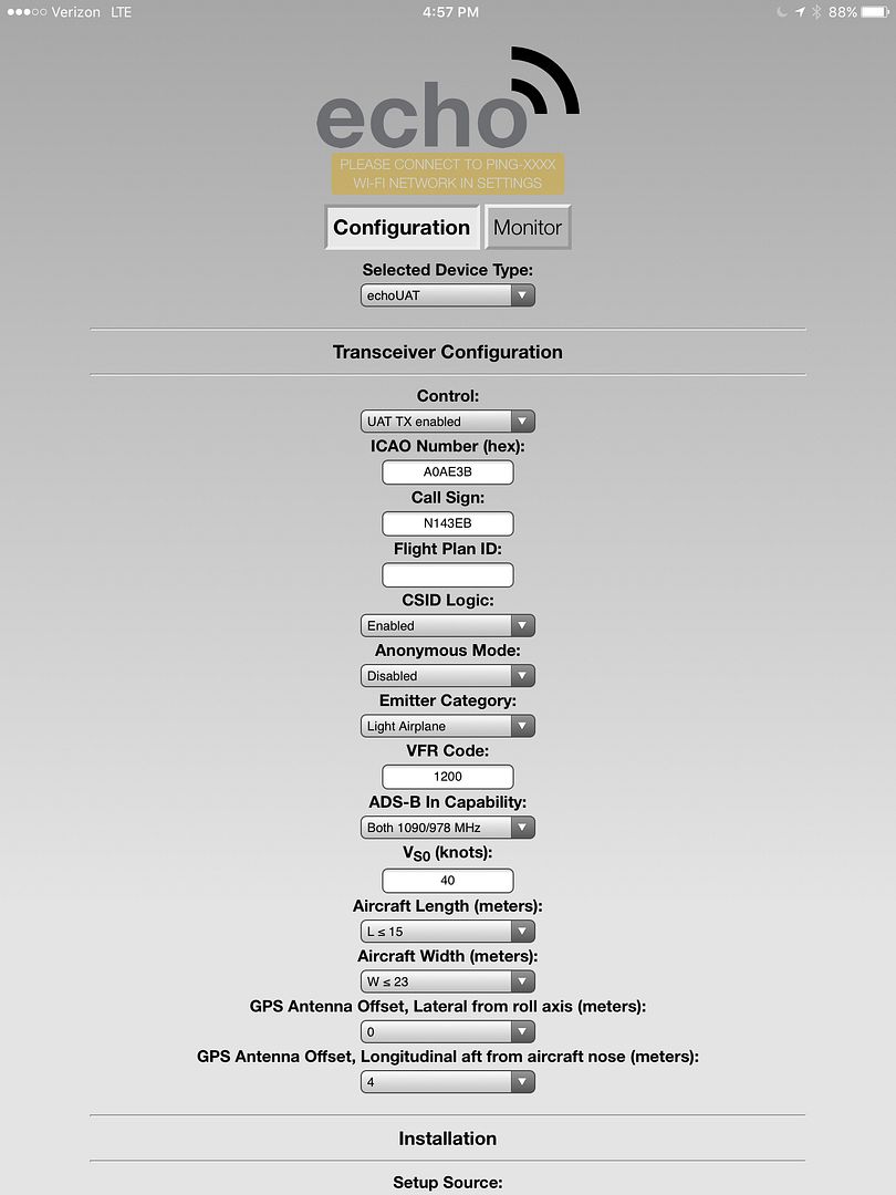

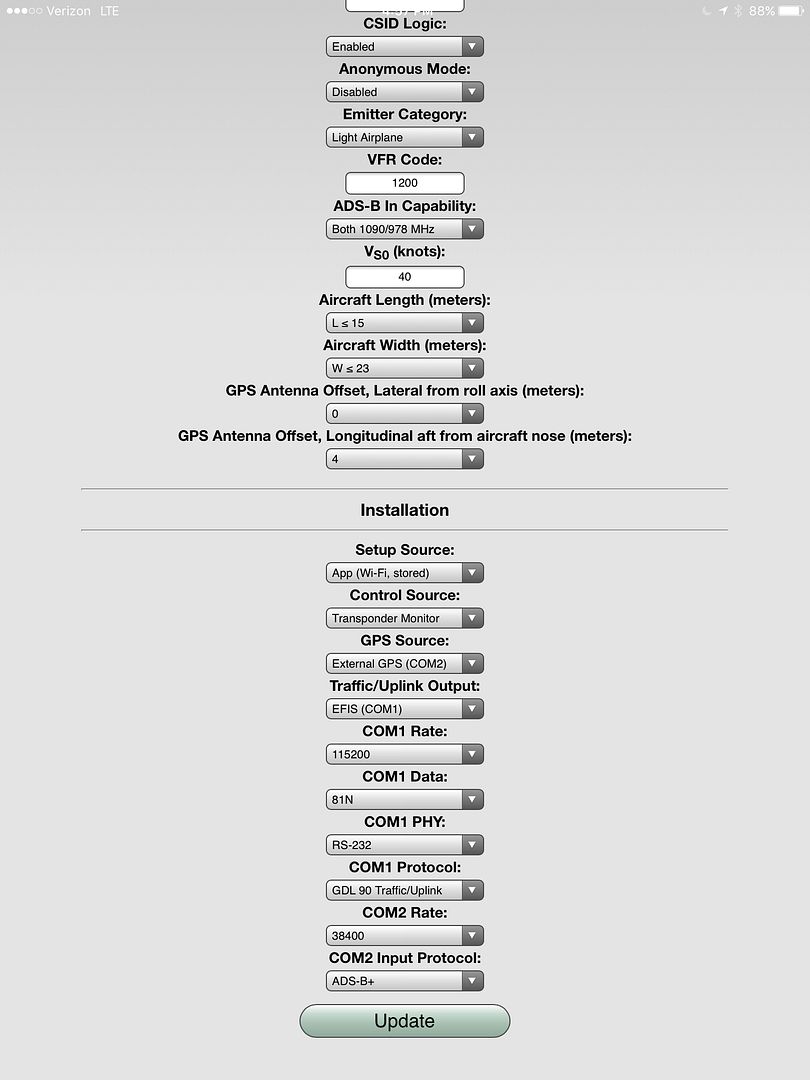

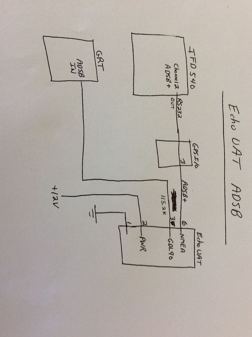

I put another 10 hours of flying on our EchoUAT with a flight from NH back to TX with headwinds the entire trip. The EchoUAT is working fine. The purpose of this post is to show how simple the install of this UAT is in an experimental plane.
This is the block diagram showing the few connections. Probably the hardest the the connection to the gps. I have an Approach Hub so the gps hookup was easy. The GPS I/O box is the hub.
This is the configuration app for this wiring diagram. Change the N number and hex code and change the adsb+ gps baud rate to whatever your gps is set at. If it is a G430w it is likely 9600.

I just got mine up and running I have a GRT Hx, Garmin 430w, GTX 327 setup.
Install was easy, just slow for me as my first dive into the systems and wiring on this airplane.
Power from the radio switch with 1 amp inline fuse / ground to ground.
One wire to pin 54 on the 430w. One wire to the GTX327 (ended up not needing to be done due to my config). One wire into the GRT Hx.
Configure the ports on the GRT and 430w via the menus and turn on traffic / etc in the GRT.
For the antenna, I had just removed the GDL-39 and re-used its antenna already under the airplane so very easy there.
Powered up just fine. Connect your phone to the Wifi and use the app to configure, and now I have traffic / weather in the GRT and the same in Forflight on my tablet and phone
Last step is upgrade 430w to 5.0x to get ADSB+ enabled (cards on the way) but ADSB in is working full time now.
I'd recommend it, much less than I was expecting to spend!
