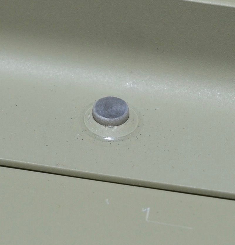

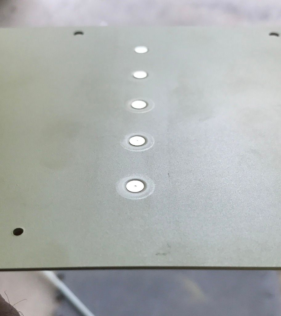

Not the best, but about as close up as I can get. The first shot shows the factory head - this pic shows the witness marks you will get around the hole when the dimple has been fully set. The pic is a little deceiving as it looks like the rivet sits down in the dimple - it is flush with the skin.
This pic shows the shop head side. I did debur, but you can see a slight bur that remains. This isn't visible to the naked eye
Another poster mentioned a straight edge across the rivet/sheet, which is a good test, so the last pic is a razor blade, back lit with a flashlight, over a couple factory heads. This shows the relative flatness of the finished product

Yes they Really look nice I almost cant believe you got this dimples with Cleveland dies
NOw when i look at it you dimpled with primer and. It actually makes skin thicker
I actually reduced depth to get my modified dimples look like this
