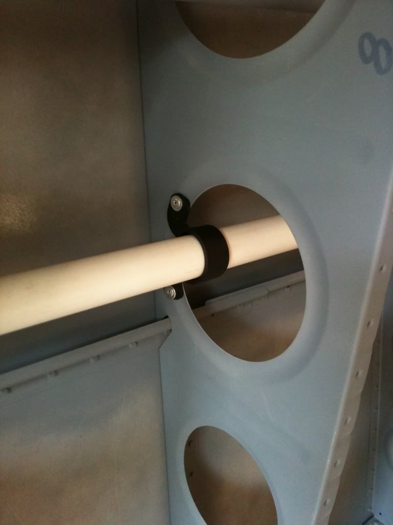

I think it will make your life a lot easier some day. I used drain PVC tube. It's lighter wall than supply PVC.
Also used these supports (with pull rivets - put an aluminum washer under the rivet head to spread the load some) from the plumbing supply store:

I decided to separate my antenna wires from the strobe and resistive load wires. The latter go through snap bushings in the rib holes closest to the spar and are secured to the spar at each inspection panel hole. The antenna wires go through aluminum conduit (using the smallest wall thickness listed in ACS) which is supported by the snap bushings in the ribs in the "alternate holes" in the Van's wing wiring PDF. I didn't like the flammability of the plastic conduits and the thin wall aluminum tubes are light. The main reason I like the rigid aluminum tubing is to guarantee no contact with the control pushrods.

I went with the PVC irrigation pipe.
Being smooth, it's easy to pull wire thru, and will be later if I need to redo anything.
I drilled the ribs just aft of the spar, as low as possible. The wire enters the fuse just below and forward of the aeleron push rod holes.
