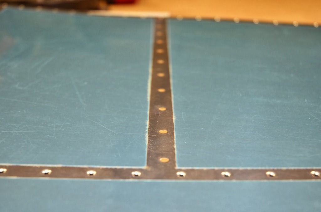

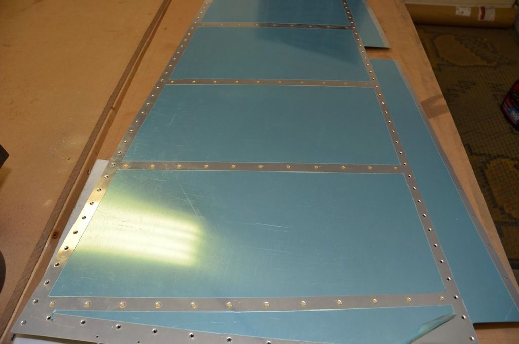

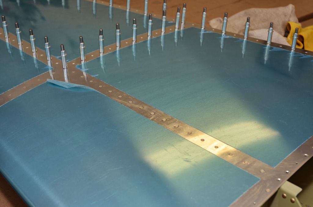

Could you please post high res picture of your dimple Cleveland 426-3 and C-farme?
I'm not at home right now, but found a few from the very beginning of my build in my log. The first two are the rudder (back riveted); the third is the vertical (gun). The pics aren't the best, but the dimple/rivet/skin is almost perfectly in plane. Again, this is from a few forceful wacks and Cleaveland dies.

There is expensive vs. cheap, and there is [whichever] good vs. defective.
There is structurally fine, and there is 'looks perfect' (in addition to structurally fine). No question to me that what's shown in the pics is safe.
Perhaps the photos over-emphasize potential issues. I took a zoomed pic of one of mine (most say my riveting is quite good) and the pic over-emphasizes the edge of the dimple next to the rivet head. Have you laid a straightedge across the driven rivet heads? For 'looks perfect': On a flat skin surface, with the straightedge along the rivet heads and 'back lit', you should see minimal light between skin & straightedge, and have a hard time picking out where the rivets are located. It should be somewhat difficult (not impossible, but difficult) to catch a fingernail on the rivet head.
There's a milspec for minimum/maximum hole size for each rivet size, & IIRC, using a #40 drill, light debur with a 3 flute debur tool and dimpling will take the hole out to the max in the spec, and if you're even slightly aggressive with the debur operation, it will go over the max diameter. It wouldn't surprise me if half the -3 rivets flying in RV's were driven in holes that are bigger than the milspec max.
FWIW,
Charlie
