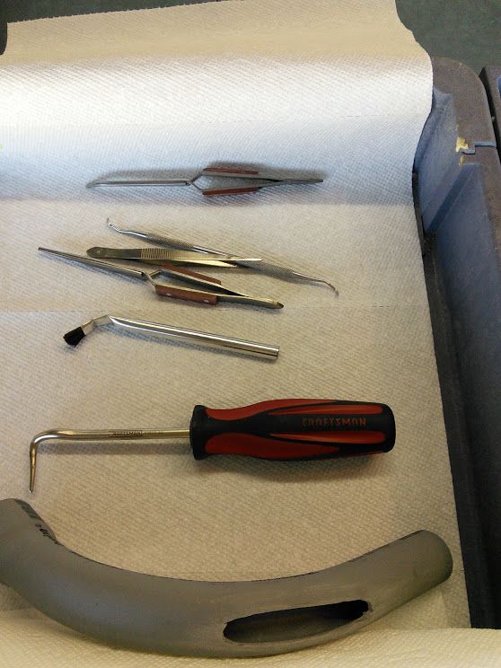

No pictures because I forgot my camera but yes, I had not one but two locations where pliobond was on the shaft under the seal. I'm convinced that was the cause of the seal wear. I don't know how to be more careful with that stuff so the next time around I will use DC 737.

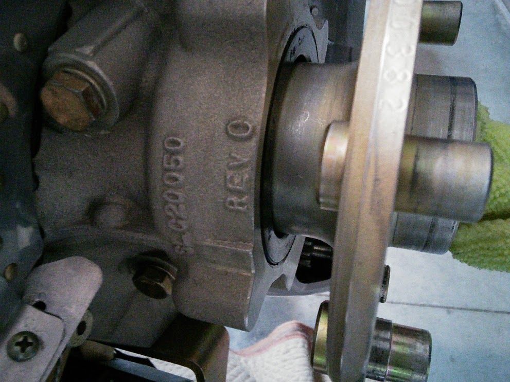

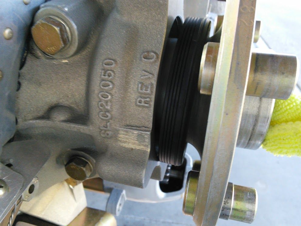

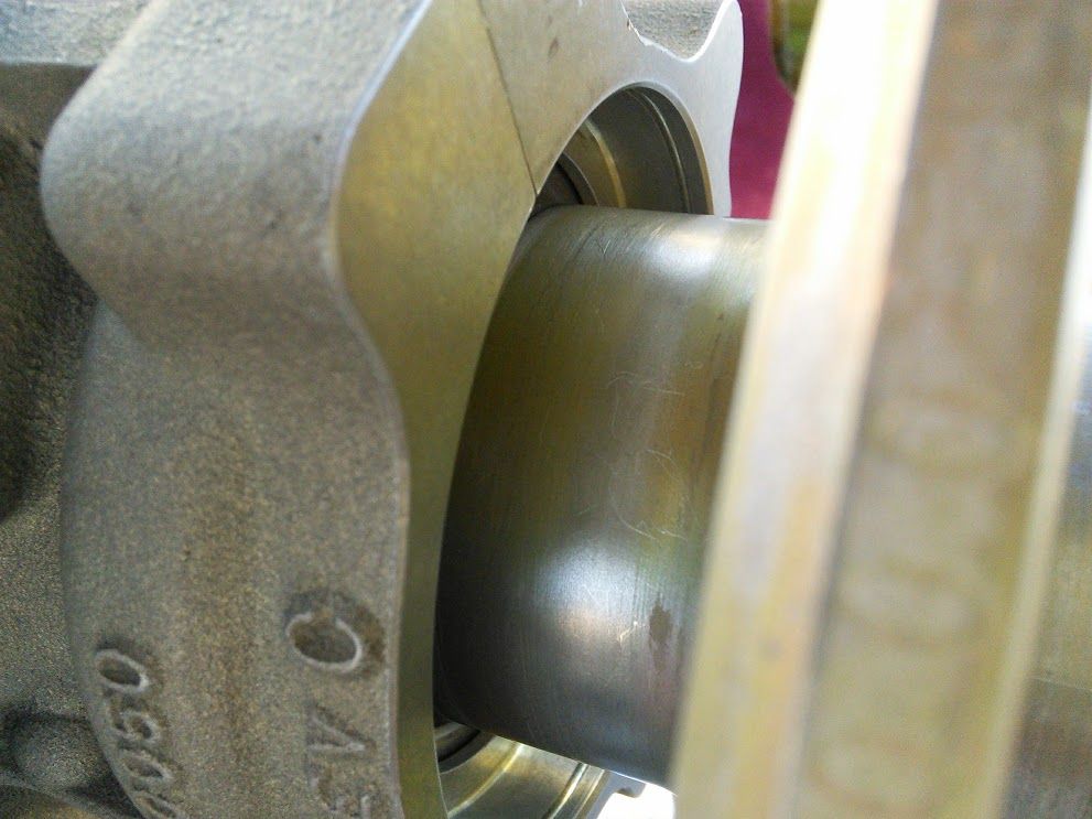

no, I didn't add lube to the crankshaft before or this time. it's a tight working space and I didn't trust myself to contaminate the bonding surfaces. it's a personal call.

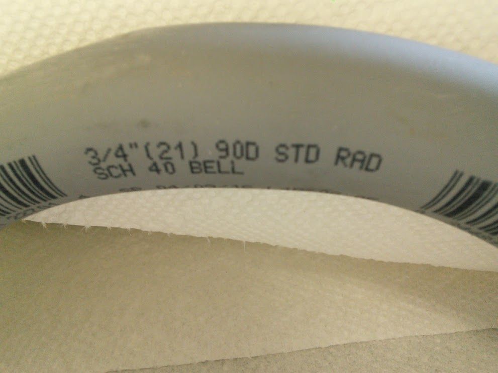

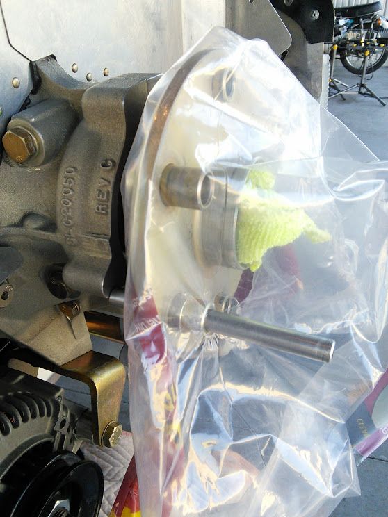

some tools. stab the old seal and work it out. I also used a wooden trim piece to help push the edges. I heated the seal in boiling water to soften it before stretching. plastic bag to help it slide over the flange. I needed to use small hemostats to hold the spring in order to link it. the tweezers in the photo were not sufficient. applied a thin coat of dow corning 737 to the inside of the crankcase side and then the outside of the seal and put it in wet. if the RTV sets up before install it will not hold, as I was told. I had more control with the application of the RTV than the pliobond I had used on the previous repair.
note: the conduit is the seal stretcher. cut a groove to match the crank flange.
note: MEK used to remove the prior pilobond. my final clean of all surfaces was with brake cleaner
total cost for part, materials and shipping = $50

I'm having a hard time visualizing how you use the conduit.
I've read the whole thread, but not some of the reference materials that might explain it, so sorry if it is already described somewhere.
put conduit under the seal. put cut slot on the flange and pull.

the vent is open. extra slot cut in the rubber breather tube. the first failure was caused by the white silicon adhesive used at the factory. they don't use that anymore. the second failure was my fault because I used pliobond and some of the pliobond adhered to shaft and wore the seal after 100 hrs. for the third seal I used Dow Corning 737 adhesive. I hope that solves the issue.
no leaks so far.
