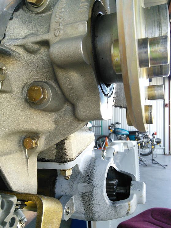

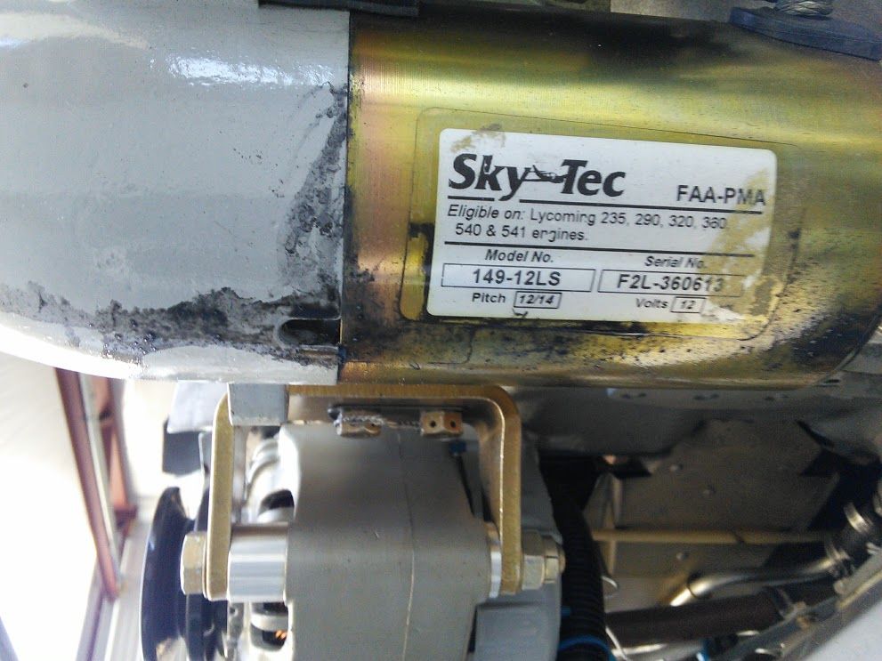

history: I replaced the original seal 100 hrs ago (460 hrs total time) because it became totally unseated and was resting on the crankshaft. It was replaced with a similar seal using Pilobond adhesive rather than the original white RTV. Yesterday upon oil change I found it was leaking. The Pilobond is secure and the seal is seated and the leak is between the crank and the seal. There is a black color to the leaking oil but my internal oil is clean so I can only presume the seal is wearing but not sure why. question is: how to remove the seal for replacement?

Take a cotter pin removal tool, poke it into the seal and pull. Then cut seal with a knife. Make sure to replace the spring with the new one that comes with it. Ensure the spring is fully seated on back of seal before inserting.
