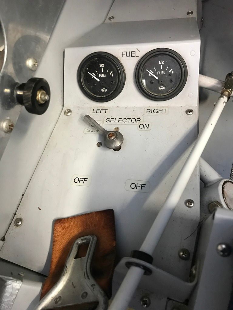

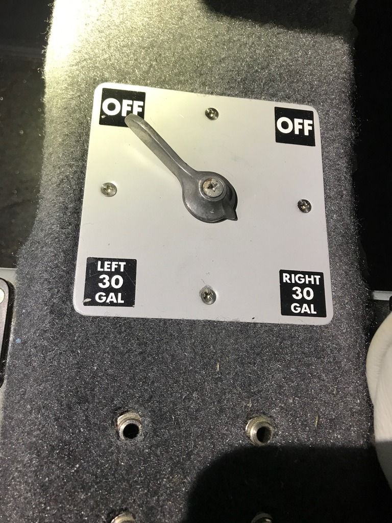

The bottom line is that IF the airplane is designed for a BOTH position on the selector it will probably work OK (Varga Kachina and some others are exceptions). But IF it wasn't designed for a BOTH, and it's already working well on approximately 10,000 flying airplanes, then we probably shouldn't mess with it. Just a thought.
However, I do wish we would standardize the way the fuel valve is installed in our RV's. Just today I performed a prebuy on an RV-8A that had the fuel valve installed such that the LONG arm of the selector points to the chosen tank. The little point on the small side of the selector handle had been ground off.
In my hangar currently undergoing a CI, I have an RV-10 that has the same valve installed such that the little pointer on the small end denotes the selected tank.
Perhaps we could all begin to paint the proper end with some bright red paint or something?
Vic

As you know, but others may not, in "legacy" RV''s like my 6, the fuel valve is plumbed in a "cross over" configuration. In order for the fuel selector to be correct, the long side of the handle becomes the pointer. Hence, the pointer was ground off to avoid confusion. Painting it red would be a good idea.

I agree. Guess my 1999 RV-6 is legacy but it is plumbed so the little pointer indicates the tank in use. The little pointer was painted red while the plane was still under construction.
I've done EAA inspections on RVs where I couldn't tell how the valve worked due to the lack of a clearly marked indicator. This became a point of discussion...maybe a dot of red paint will prevent a tragic accident by a future owner.

Ahhh...but does the red dot mean "danger, this end isn't the correct end!", or does the red dot mean "this is the important end!"
Mikey was built in the days when the handle was used as the indicator, and the little pointy end was ground off. I never liked that - just seemed backwards. We changed that valve handle during one of the upgrades, and it is much more intuitive.

One could paint the correct end of the valve a color (red) and paint the same color on the selector cover plate so they line up.
