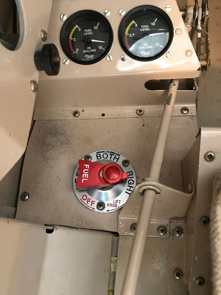

Please, please, please don't do this. I was performing a prebuy on an RV-8 today and for the second time I found a fuel valve with a BOTH position. Huge NO-NO! A both position in a low wing aircraft will fool you into thinking it works correctly, especially when both tanks are either full or above the fuel pickup. But let one of the tanks get below a fuel pickup and even if you happen to have a full tank on the other side, it will suck air. Probably at the worst time, like when turning base to final. More accidents are caused by modifications to the fuel systems than any other modification. It was a even very nice Andair valve, too. 😓

Wasn't built by the current owner, who is now deceased. The airplane had been completely destroyed once, then rebuilt, and ground looped twice after that, so who knows who did this mod.

When I was a DAR, I once would NOT issue the Airworthiness Paperwork to an RV-6A builder/owner/applicant till the builder changed the fuel selector to one that did NOT have BOTH. I explained how one tank could be full, the other sucking air with the switch in BOTH and the engine would quit running.
The builder / applicant changed the valve while I waited / watched.

it is my understanding that a L R fuel valve with no "BOTH" position still has one of you place the selector half way between the L and R. I has to be this way so that when switching tanks, the 2nd tank kicks in before the former tank is cut off. If so, be sure to place the fuel selector all the way to one position or the other and be aware of consequences for failing to do so on a low wing aircraft.

The Aero Commander 112 and 114 single engine low wing airplanes have fuel selectors with a both position AND a POH that recommends using the both position. I think some here are a bit extreme. Any empty tank will allow "sucking air". Doesn't matter if your fuel selector has only a Left and Right position or also includes a Both position. When the tank is dry you simply change from the empty tank. If the pilot understands his fuel system as he is supposed to then there is no surprise. He will know what happened and what is to be done to correct. It's a standard checklist item to place fuel selector on fullest tank when taking off or landing. The certified design accounts for running a tank dry and switching to a tank with fuel. What's the big fear here?
