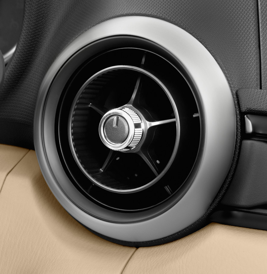

I was in Japan for a couple of weeks last December, and in several vehicles there I saw these neat air vents that are like an eyeball, with a dial in the center that opens and closes a set of radial vanes to control air flow. I wasn't sure where to find them until I rented a Chevy Sonic during a trip last month. Very similar to what I saw in Japan. I think the vehicles in Japan where I saw them were a Mazda and a BMW. Anyway, I think I have found them here: https://www.ebay.com/p/?iid=25198877...pItem=1&chn=ps
Now, they are rather large in diameter, and possibly too deep for an overhead console, but I am still considering them for the foward and rear fresh air vents. Bonus: They're pretty inexpensive, and probably available at an auto wrecking yard. I may pick one up just to see where I could make it fit.
Edited: Now that I look at these pictures, I see these are different than the ones I saw in Japan in that they have a folding butterfly behind the vanes to regulate airflow rather than the radial "petals" that rotate on their individual axes like I saw over there. I will now have to find those. I bet the "petal" ones aren't as deep, since the split butterfly has to have at least a depth equal to one radius of the opening...
Edited: Here's an Audi air vent that looks like the ones I am thinking of: https://services.edmunds-media.com/i..._31815_717.jpg
Edited: Are these the Mazda air vents the OP was referring to?
