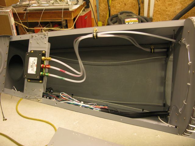

This is where I put mine. It works well but is difficult to access with one hand now that the turtleneck is on.
I think it would be easier to work on if it were mounted under the longeron and further forward... Maybe next time

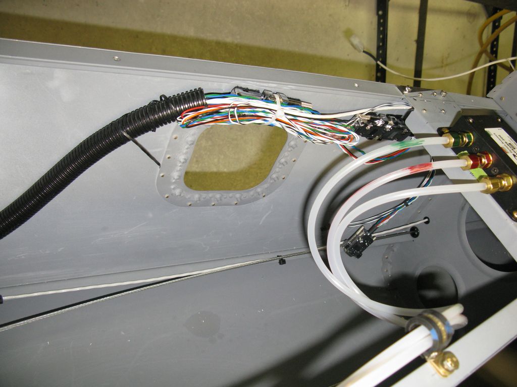

Old 05-15-2017, 01:18 PM
dwrichey's Avatar
dwrichey dwrichey is offline
Join Date: May 2009
Location: Reedley, California
Posts: 85
Here's one option.
