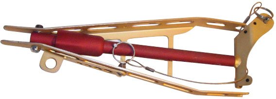

have you Ideas for me, what ist the "best" Rudder fixation for longer Parking during Cross flights...
It should be simple to Montage, Light, and should stopped and fixation the Rudders savely. (specielly Empenage Rudders)
Maybe you have Informations or Pictures for me. (I will do a Homemade Solution wenn it's Possible)

Manfred,
This gust lock has worked well for me.
http://antisplataero.com/products/ultimate-gust-lock

Take a long ( 12 or 14 inch) #40 drill and cut off the the end so you have only a smooth rod. Measure the distance from the rudder horn on one side and the rudder stop. Using heat on the rod, bend two 90 degree angles to form a "U" shape. Drill 1/8" holes in the stop and horn. The "u" should drop in thru the top. Make a bottom strap with two holes to slide onto the drill rod when it's in place. You can use aluminum for this piece as it doesn't need to be as strong as the rod. I have a "remove" banner tied to the "U" which I loop around the strap to hold it in place when the lock is on. Very simple, strong, and easy to use. If you need pictures, send me your email.

Same here, spendy, but so was the plane

That said, the AntiSplat lock is really nice.

Gust buster is my choice...
https://www.aircraftspruce.com/catal...rs05-11899.php

I used a scrap piece of aluminum bar, bent to fit flush over the rudder horn and rudder stop and hole cutout to clear the rudder cable bolt head. Two small screws and wingnuts hold it in place. Put a big red flag on it, too.
