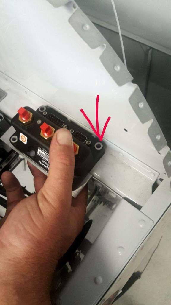

I'm not sure what stage your up to Roger but I mounted mine here
Very rigid and an easy install with some 3/4 angle.

Thank you for the advice.
I see Steve's point about the pitot connection and I like Nathan's location so that sorts it for me. It will not go on the GDU.

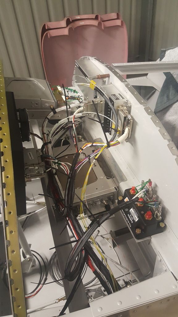

I tell a lie Roger! I've been away over the Easter period and had no access to check but the angle is actually 1"x 1.25". Here's another photo behind my panel so far.
