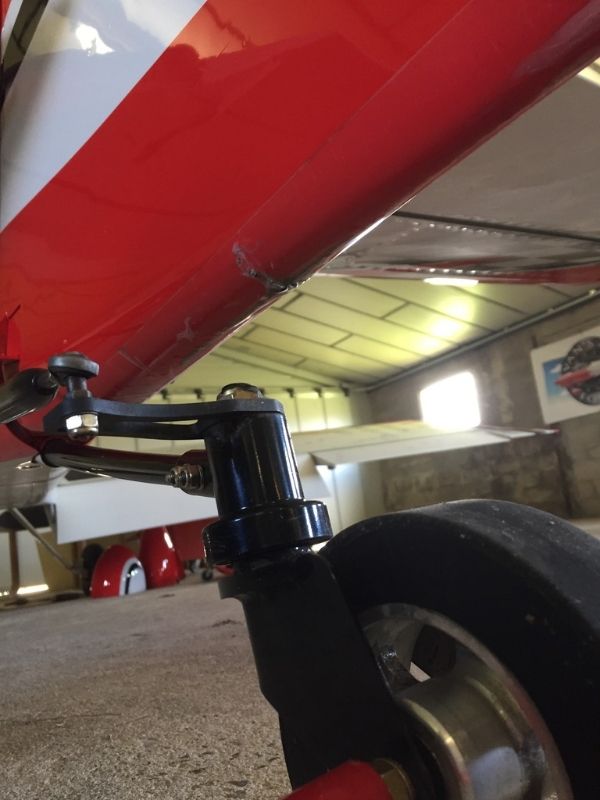

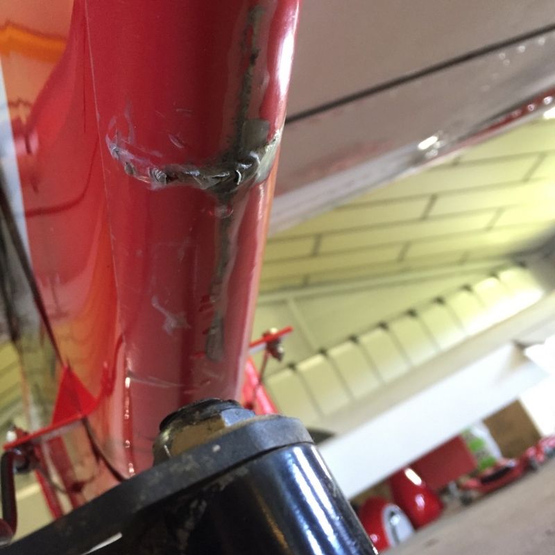

Good morning,
a good friend of mine has built a beautiful RV-7 last year.
But he has a small problem: he operates from a grass strip and with the bumps the top of the tailwheel assembly hits the bottom of the lower rudder fairing.
I'm working on my fairings now so I'm very interested on a solution to this problem.
What have you done to solve this issue?
Thank you.

Default Solution
Hello,
Pics in the first post were mine. I measured the gap between the nut and the bottom fairing and I had only 1,9".
So the only solution I founded has been to create a way for the nut in the rudder fairing. I join some pics to explain. I have now a gap of 2,4". I think it is enough for all the bumpy grass runways I'll experiment..
