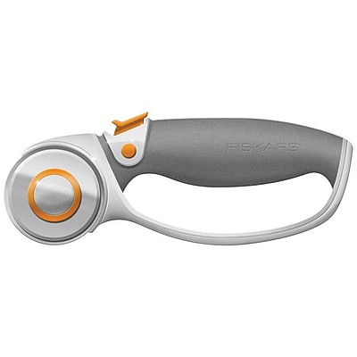

I really like the pizza cutter style rolling knife (no idea what the correct name is) for cutting the glass cloth.
http://www.staples-3p.com/s7/is/imag..._sc7?$splssku$
Resin------West systems epoxy works, may not be the pinnacle of things in the epoxy world, but works just fine for our needs. Ditto for the proportioning pumps they sell. If you want to be really precise get the scale and measure that way.
Rotary Cutter at Walmart $8. All else as Mike suggests.

Pizza cutter

+1 for the rotary cutter wheel. Spruce for a nice one, or Walmart or craft store for a plastic one. Get an extra wheel too. A burr on the wheel will drive you crazy when you make a nice cut and it misses occasional fibers😡.
