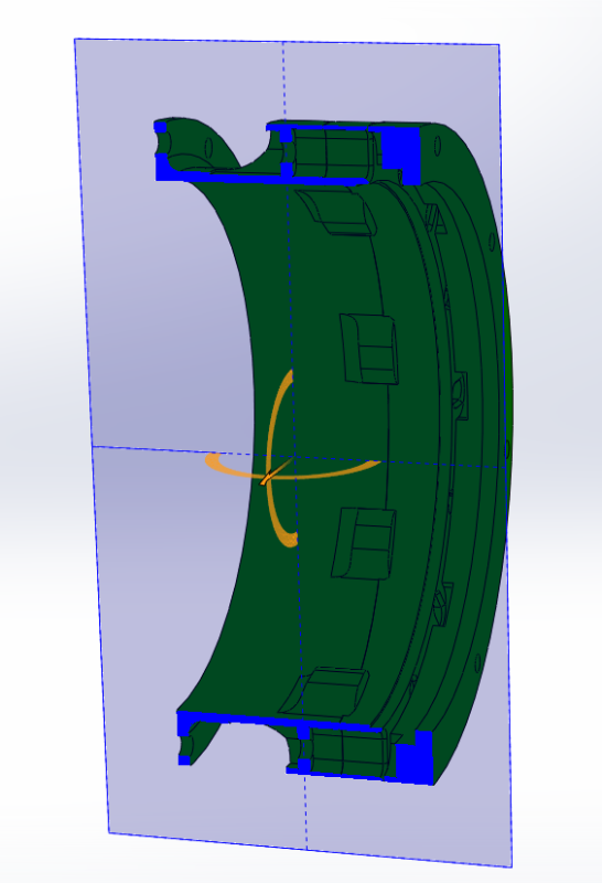

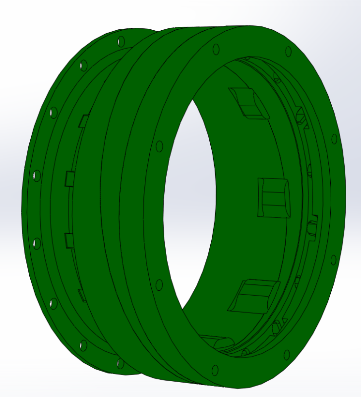

Default PAR36 design
has promise but will not fit RV-9 wing tips. maybe someone else can use it. still some dimensional tweaking to do. weight without fasteners = .39 lb. rotate base and wedge to achieve beam angle. I need to add some cooling vent holes in the base. you know, a couple hours Thursday and three hours today, hit the print button and go to the airport and go flying. when you get home the parts are ready.... it's a new age folks. and many thanks to EAA and Solidworks for the free software.
comes with drill template
maximum angle, clock base and wedge to angle desired
zero angle

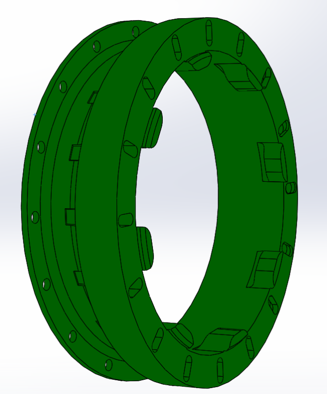

Default not sure what it's good for
more of an exercise than anything. +/- 10 degree option at install. this light is rated at 18W and the max operating temp ~120F. I suppose I could chop off the base at the bottom of the lower wedge and eliminate an inch but that would eliminate those cool hex nut features.
