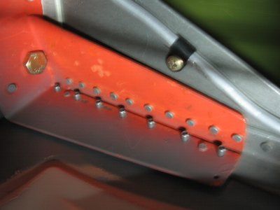

Default Vertical fin attach
Here's another one on an RV-7 found this past week. It had been flying for 7 years, and allegedly maintained by an A&P. Personally, I think the riveting shown should have been caught on the initial airworthiness inspection, if not the 6-7 subsequent inspections. I think 2 out of the 7 rivets are acceptable.
Just remember that there is a simple formual for determining a set rivet:
It should be approximately 1/2 the original diameter in height and approximately 1.5 original diameters in width. Diameters here are referring to the unset rivet measurements. As an example, a 1/8" rivet as seen here (AN470) should measure 3/16" across and 1/16" high after being set. After a while you will be able to eyeball it.

Looks like those could be hit again and they would be perfect

Originally Posted by vic syracuse View Post
... I think 2 out of the 7 rivets are acceptable.
Vic, I agree completely that these photos are very helpful.
One point - I assume you mean 2 of the 9 rivets there are ok? Can I guess you mean the one on the far left and the one at the lowest point on the photo? They seem to be slightly overdriven IMHO, but I agree that they look "ok", from the angle I can make out in the photo. Perhaps the bottom right corner rivet might be "ok", if slightly underdriven. If a picture is worth a 1000 words, seeing it in 3d with two live eyes is worth 1000 pictures.

Yes, my bad. I guess I can't count.
The two you mentioned are set properly. The others could be fixed in about 2 minutes with a gun and bucking bar. They are easily accessible.
There have been a few comments about the Vans aircraft being over engineered. No doubt. I remember taking my first piece on the rv-4 to the FAA when we had to to get preclosure signoffs. He asked if I was building a tank. I didn't know any better until I looked at the inside of a Cessna tail. Yikes! I didn't understand how it stayed on, but I certainly understood why they were cracking from everyone pushing down on the tails to move them around!
That being said (that they are overengineered) they should still be built right. Anything worth doing is worth doing right. These pictures I am showing you are not becasue I am picky. Quite candidly, none of these would have been given an airworthiness certificate if I was the DAR. A lot of them are fixable---some even during the course of the inspection like the RV-7 vertical fin. Others, like the RV-10, are going to take a major rebuild.

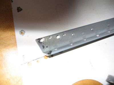

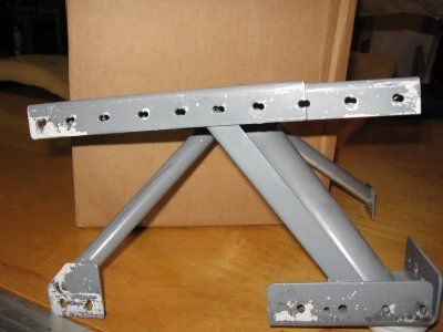

So, in the spirit of what else might be lurking behind visible poor workmanship, take a look at the following:
Missing rivets on the horizontal stabilizer. Should have been caught on airworthiness inspection.
Pop rivets on the engine mount attachments. Really?
How's this for wallowed out holes on the landing gear attachment?
This is the horizontal stabilizer attachment, the first clue that one might want to look deeper.
Real friends don't let their friends buy RV's without a thorugh prebuy.

On the subject of acceptable rivets, I'm wondering is it ok if you have a properly formed shop head that is "overdriven" (won't fit in the rivet gauge), but still meets the minimum head height? Hope that makes sense.
