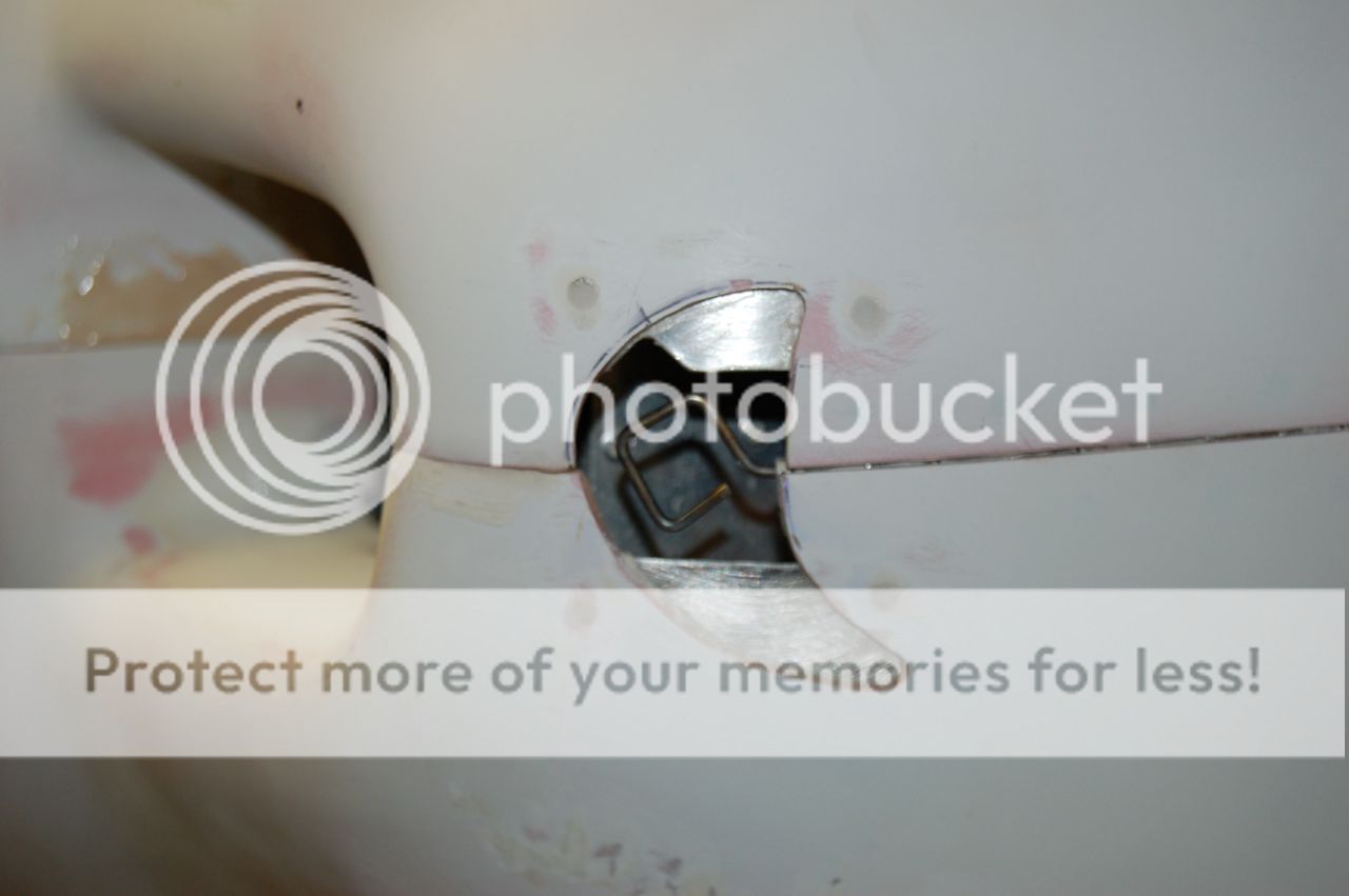

My now 7 year old RV7 has begun to loosen the cowl hinge pins so that they are backing out. Friction no longer seems to hold them in place. This is most prominent on the lower cowl horizontal pins, and on the top cowl horizontal pins. How are others "securing" these pins to keep them from backing out?

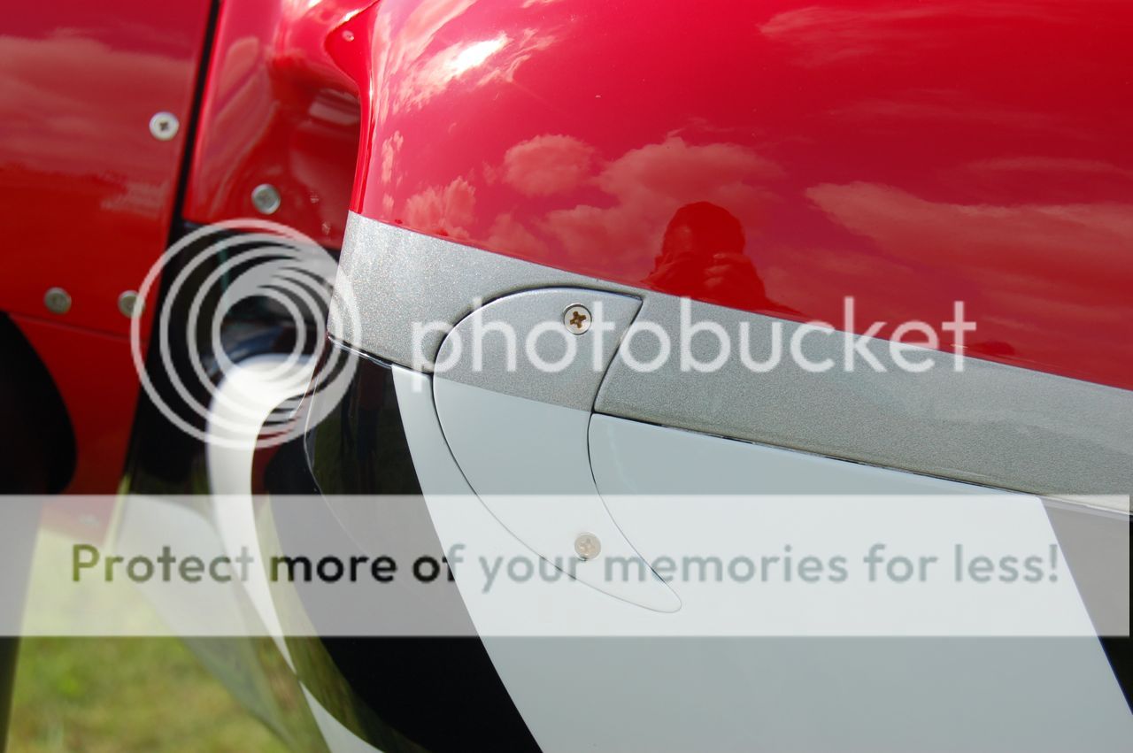

I copied an idea from an Osh award winner. They do back off a bit but the plate is holding them.
