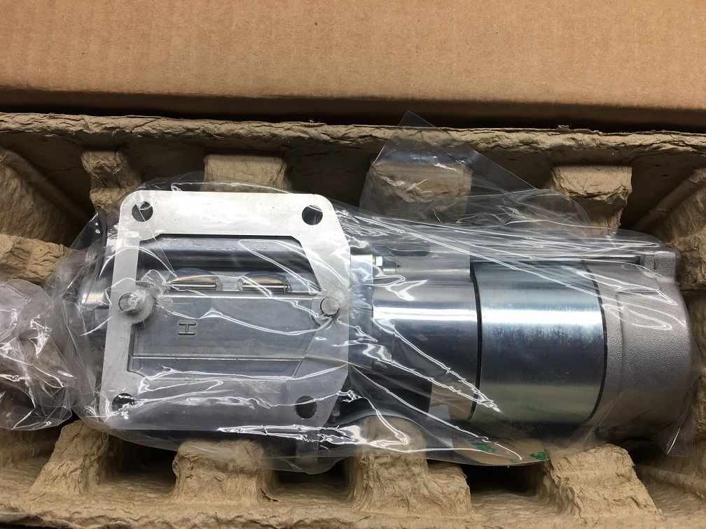

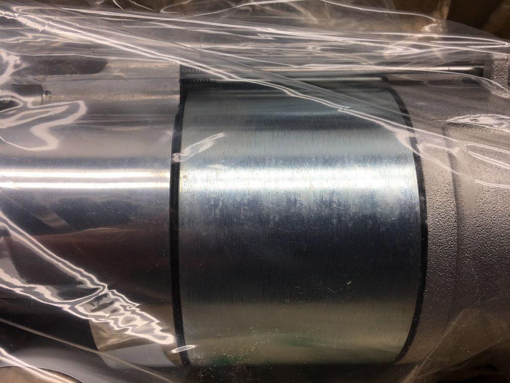

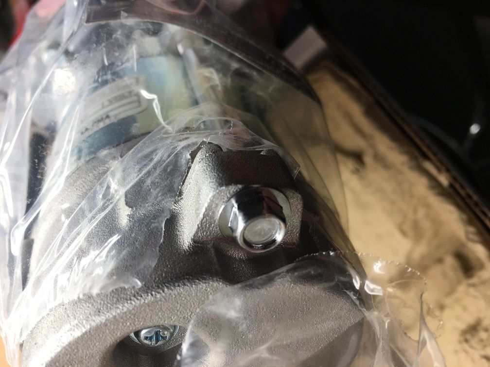

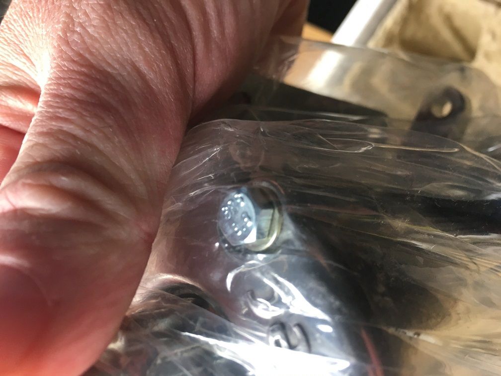

  #28
Old 02-21-2017, 10:58 PM
CharlieWaffles's Avatar
Join Date: Nov 2010
Location: West Linn, Oregon
Posts: 1,351
I was able to get my starter sent in and even though it was first installed over 3 years ago, they replaced it under warranty at no cost. I noticed they have made a few changes - see photos below. The bent tabs appear to have been replaced by internal teeth style lock washers. In addition, there appears to be a rubber gasket between the housing sections - where the fretting has been reported.
