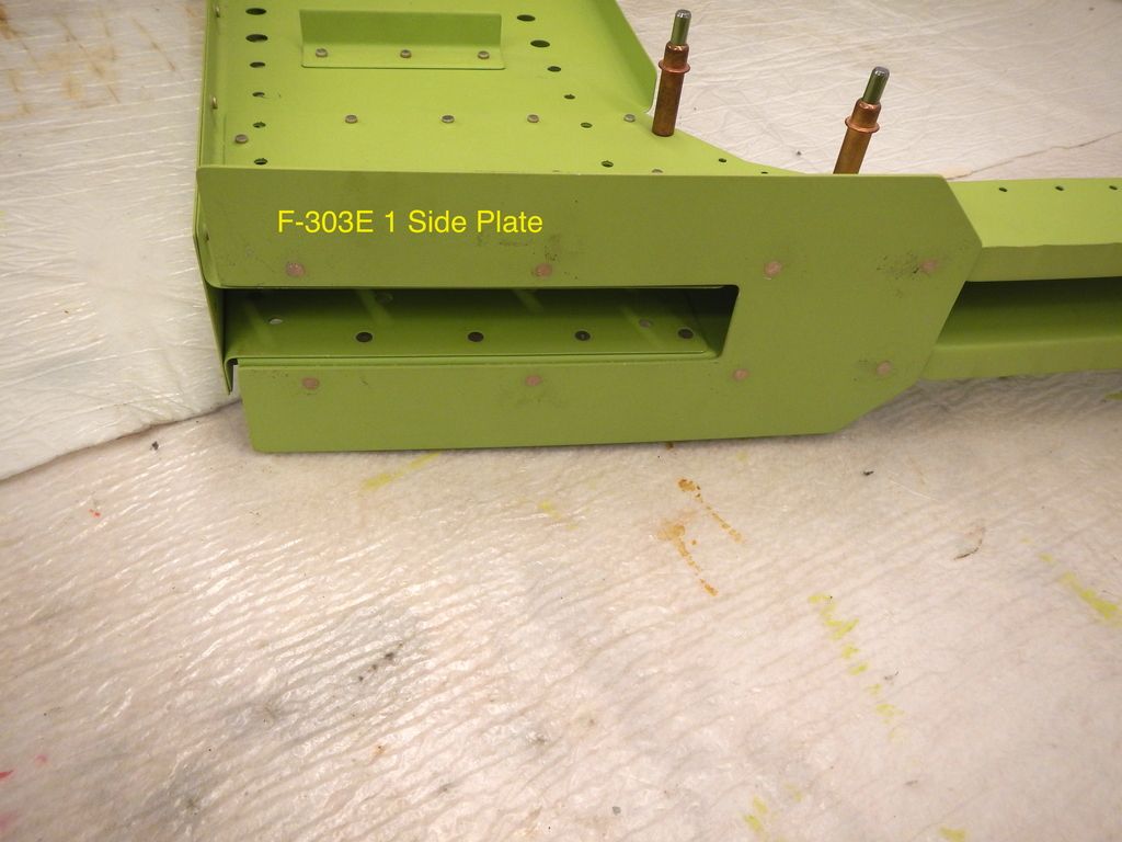

Not that long ago, I went out to the shop and encountered this dismaying view.
Had to do something about that. It seemed best to work from the center out, so after riveting the F-304 bulkhead to the F-313 center seat rib, I riveted the seat rib to the F-305 bulkhead.
Next came the middle non-center seat ribs, the F-314 ribs. These have the mixer mounting bracket attached, so I had to rivet those on first. After attaching these to the fuselage, I had this.
Then I clecoed in the outer seat ribs, the F-315 ones. Guess what? There are a couple rows of rivets which are buried in the F-303 spar bulkhead. I forgot about these when I riveted on that bottom splice strip, the blue one just above the marked holes in the photo. Oops.
I've taped some rivets in place for these and arranged for someone to come out and give me a hand with these. I think that they can be back-riveted. We'll see.
The proper sequence would have been to back rivet these to the bulkhead before I riveted on that splice strip.
In other news, a friend sent me some 1/8" pitot-static tubing - thanks! I already had some 1/4" tubing. This shows both sizes. The 1/8" tubing is MUCH easier to fiddle with. The SB187-2 plastic bushings that Van's sells fits it perfectly, and McMaster sells a variety of fittings for the skinny line. The pitot line in the left wing is 1/4" and I'll leave that; it'll join at a tee.

before starting the wing construction I decided to build the center section. What happened is, that I riveted the outer seat rib positions . Drilling these rivets out should not be a problem . Furthermore I riveted the F-303 E-1 Side Plate. Do you think I have to remove it also?
When you riveted the seat rib to the center section, wasn't it possible to insert a heavy bucking bar into the spar gap, driving the manufactured head from the seat rib side? Maybe I misinterpreted your description.

Peter, at a minimum, you'll have to remove the rivets in both the red and blue ovals. Both of those go through the F-315 seat ribs, at least on my plane.
Ideally, with the bottom strip out, we could have installed the seat rib by back-riveting it when we made the aft bulkhead.
The main problem I had was that I didn't have an offset back-rivet set. If I had been able to get square on the rivet stem, I would have back-riveted the red oval rivets using a bucking bar for the back-rivet plate, as you describe. But with my tools that wasn't possible; the rivet would lean over and be unrecoverable. Glenn suggested hitting the factory head with my T set and I did that. The T set was just barely able to reach in far enough. You can see the force I'm pressing with in an effort to get enough access. It wasn't easy. And even at that, it was good that I had an expert on the bucking bar to keep the rivet shop heads straight. He had to work at it.
This tool might work but I don't have one (yet). Bent-end set from The Yard Store.
This worked but just barely: T set from The Yard Store.
Unfortunately, my tungsten bucking bar only has square ends. If I'd had one with an angled end, that would have been lots better.
Amazing - all this way and I still get to buy some more tools.
