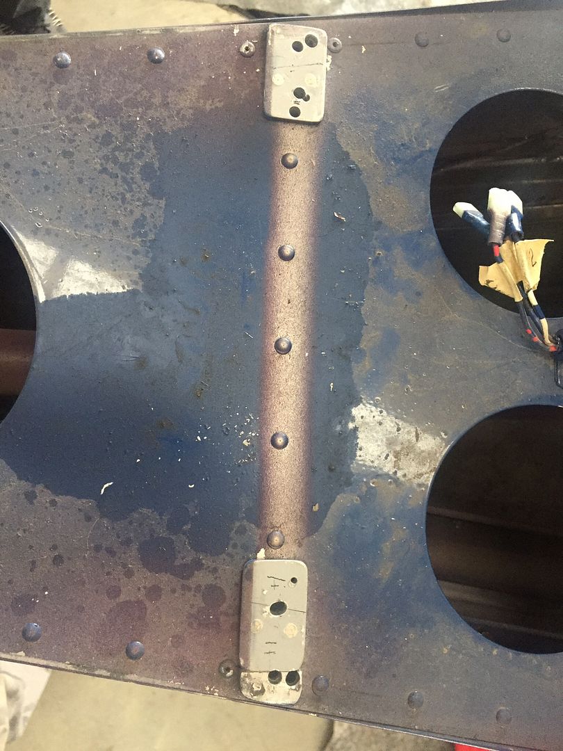

As an update, I got with Van's engineering in a fix that they approve of (the longerons were over 50% gone on the horizontal face from extra holes. Now I have to decide which little guy gets to climb back into the tailcone to drill all of these extra holes.
This thread has sure made the rounds. I have had quite a few people come into the hangar asking to see the plane that "had the bad tail".
How is the fix done?

Here's another scary tail. This one has been through many condition inspections since 2000.

Another jewel.... Being that those holes would have been covered by the HS spar, was there anything that tipped you off to look underneath? Or just a "lucky" find?
