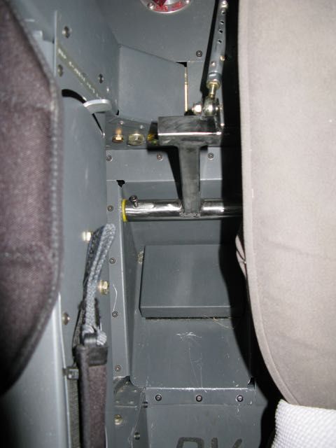

I needed instruction when I bought my -8 and had these rudder pedals made. They do work very well, but the tube as designed is awfully light with numerous holes - it can bend very easily if the length of the rear pedals doesn't exactly match where you have your front pedals - be careful. The only other complaint I have is that they eat up a substantial amount of leg room for the rear seater. Having said all that - I certainly couldn't come up with a better idea!

Heres a couple of shots of my version based on Craig's design. There is now essentially no difference in the way the rudder pedals feel from the front or the back seats.
You do lose a bit of rear leg room, and I velcroed a couple of wooden blocks in the back to rest your heels on, otherwise the rear seater is always holding "toes up" which can get uncomfortable.
On the plus side, the rear seater does not have to lift his feet to get on the rudders, and most can get off them by rotating their feet outboard.
Things to watch...
- a bunch of holes are unnecessary, unless you're flying with very short children. One or two is enough, mine have never moved.
- the inner lobe of the "pedal" sometimes touches the seat which may wear over time. If I did it again I would eliminate the inner lobe.
- I connected to the idler rather than the pedal as Craig appears to have done. Clearance is very tight at full throw and rubs a little.
- Use caution in your design, as something coming apart in flight would probably not result in a good outcome...
Thanks again to Craig, this is probably the most photographed thing on my aircraft...
