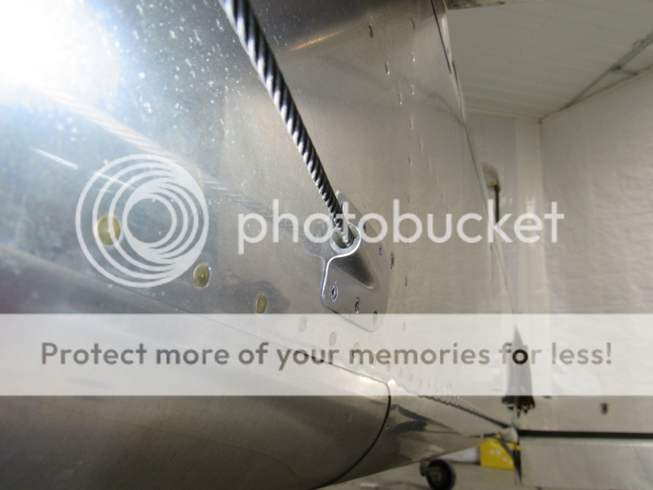

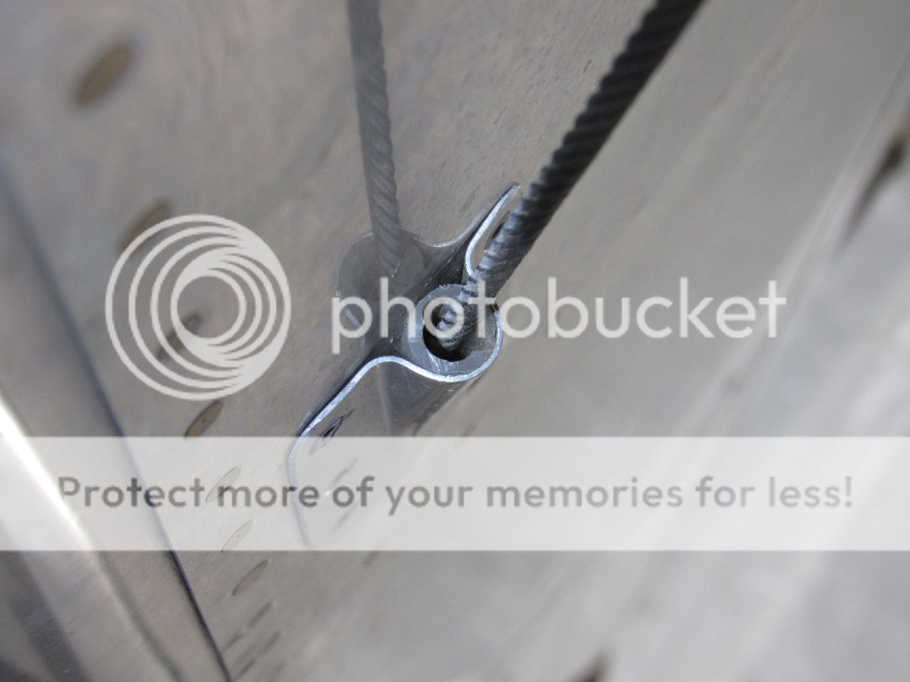

Question for those who work rudder a lot. How are your plastic sleeves holding? If the cable chews through the sleeve is there a way to replace it or the whole cable need to be changed? I turn the sleeves within the clamp every year but the wear is getting deep at 3,000 hours. Any ideas how to refurbish the plastic without replacing the cable?

I did not build my plane and you did...how was the plastic sleeve originally installed?
From my experience, the plastic tubing is pretty stiff and could be slit and popped over the cable. Seems stiff enough to hold it's shape.

If you rotate the sleeves 90 degrees, you can probably get another 3000 hours out of them!
How are the nylon bulkhead bushings holding up?

Two of them will be replaced during next inspection. The rest look good they rotate.

The next size smaller bushing can be split, slid over the cable and snapped inside the original bushing. Doing this allows for easy replacement in the future. Just slit a piece of alum tubing and taper one end..... drop it over the cable and press out the smaller bushing.

The plastic sleeves are pre-installed at the factory. The rudder cables come with the sleeve in place and both ends installed.
