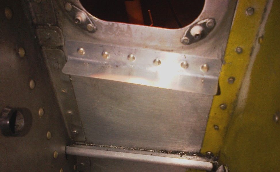

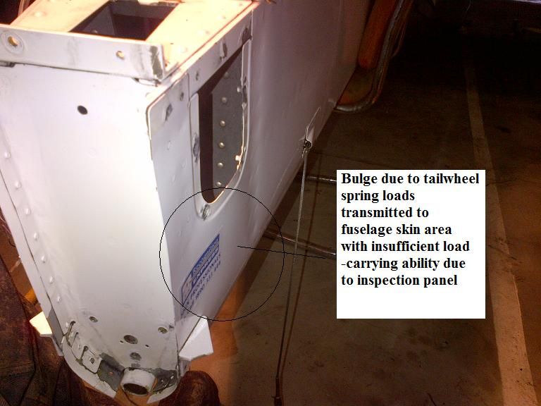

Hi,
This is quite common on RV-tailwheel using bumpy grass runways...
The cure is to rivet an angle just below the inspection plate.
Here are 3 pictures I received from another builder in the U.K.
I've done it on my RV-7 (not flying yet), very easy to do. I used some surplus angle received with my kit.
Alain.

To me it looks like a classic case of side-loading the tailwheel - it falls off the pavement and gets caught on an edge, or the two bolts that hold the socket to teh spring shear as the tail is being swung around and it falls off an edge. Either way, the tailwheel itself comes to a sudden stop while the fuselage is still trying to swing, and you put a slight kink in the fuselage structure. I've seen it on a couple airplane's, and both have had a sudden tailwheel stop event.
Just one possibility.
