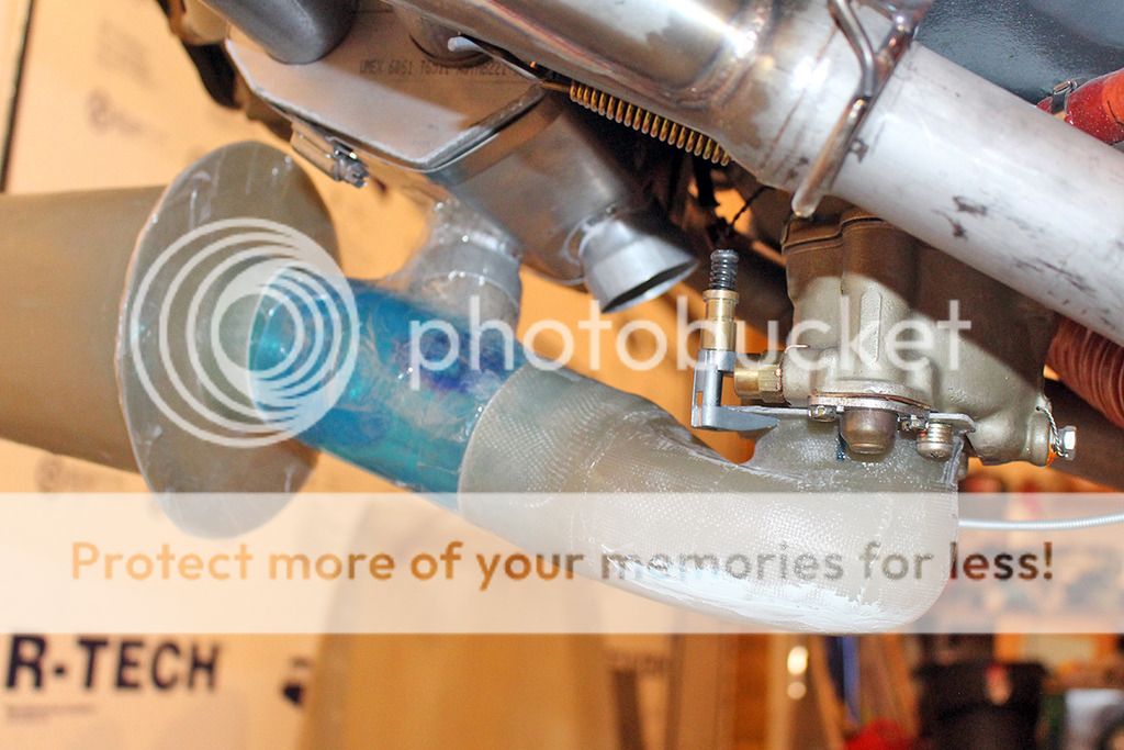

I may have a solution. I bought a plastic water bottle and did some cutting. I plan to make a mold like the photo and build a transition piece out of fiberglass and see if that works. I can get the cowl on and off as is, so I think it should work.
[IMG][/IMG]
I should be able to put my carb heat door in reasonable easy and it should give good heat at that point.
Can anyone see a problem with this plan?

Nice solution! ...the highest and best use of a plastic water bottle!

Terry, is is OK to have the hot air go in before the filter?

Hot air before the filter is optimum.

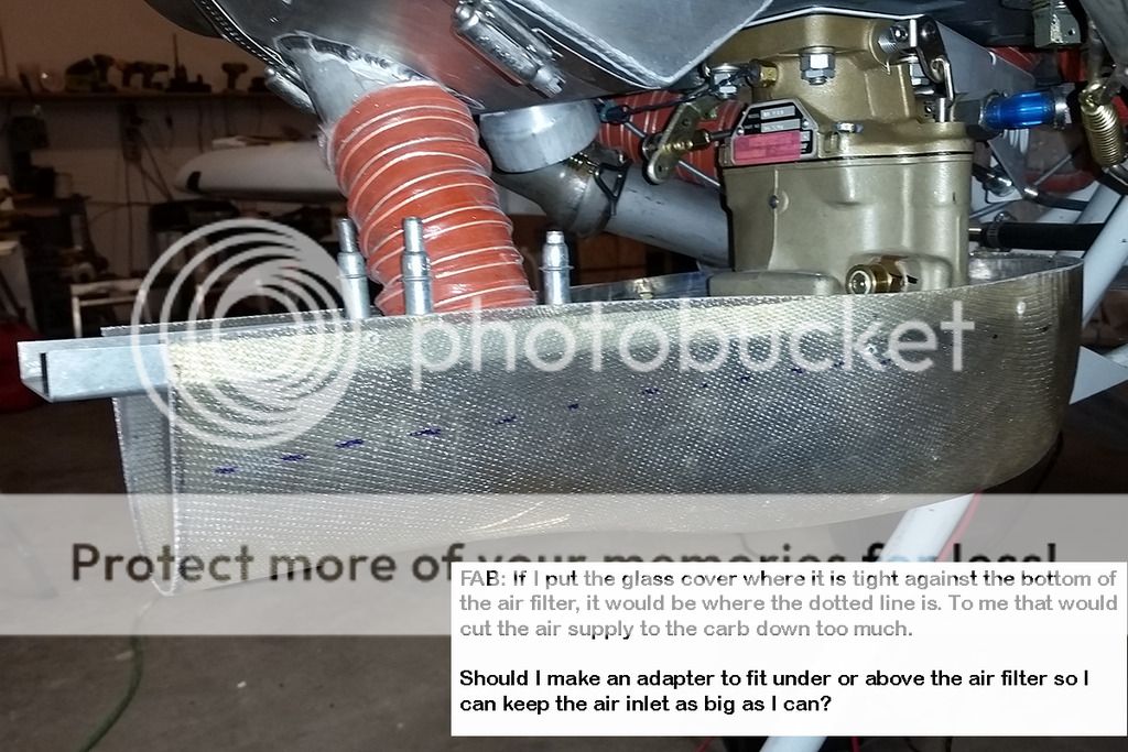

Im still working on my James cowl with a downdraft carb and heat muff in front. I have been unable to make the James supplied air box so I am working with the Vans FAB. I have things clecoed together and unsure on a couple things.
[IMG][/IMG]
[IMG][/IMG]
The cowling - plenum - FAB has been difficult for me to get done. The glassing - I am fine with, but not understanding the whole baffling - engine cooling - carb air needs, has stumped me and caused me grief!!

I believe you are missing the carb heat box that needs to be grafted onto the air filter housing. PM me your email and I will send you pictures of my install.

It is hard to see the transition piece from the SCAT tube to the FAB, but it is there. In the first picture you can see it clecoed to the FAB. I have not built the door - flap yet. Once I get everything figured out, I will put the door in.
My question is do I need to worry about how much air gets in through the front of the air box?
If I push the glass cover up to make it tight to the air filter, it makes the box very narrow.
I can make a ring to allow a deeper box if that is the way others have done it.
I have searched for pictures and haven't found any with the setup I have. I can't believe I am the first person to use a long James cowl with the heat muff up front on a carb engine.

Sorry for my ignorance, I don't have an updraft Lyc, but what filter are you using in this FAB? It looks circular from your first photo above, but maybe it's not?

IMHO, I would stick with the SJ setup you started with above but add his alternate air/carb heat option.
Also see pic on next to last page of this SJ instruction.
