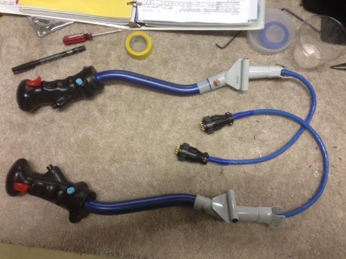

Here are my bent sticks and infinity grips:
Take a look at my build log's flight control section, starting at the bottom of the page to see how I went about this process:
http://mykitlog.com/users/category.p...&category=9467
Scroll
