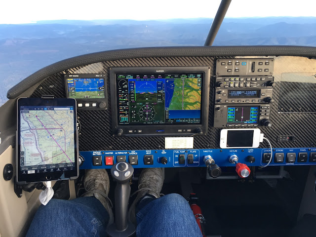

No matter what display you have if its in the direct sun it will be hard to read. I use a newer gen ipad mini and love it but I also have a kroger sun shade and I mount my ipad such that it is protected by my glare shield as you can see from the picture below. This is an ideal position for me since I can see it in almost any situation and it's easy to read/use foreflight. You can't see it very well but I have an articulating RAM mount attached to the side post that holds the ipad mini back under the glare shield. I also have USB power and the vent behind it to help keep the Ipad charged and cool. To me this is the perfect position for an IPad in the 9.

iPad air on a Ram mount infront of glove box (similar to the pic by Zuldarin except on right side). This was almost useless due to glare. Next was a 9 iPad pro in the same position, again near useless due to glare and bifocals.
Finally added a Kroger Sunshade (Best improvement so far) and the 9 iPad Pro on my right knee board. This is the best I have come up with so far. Greatly reduced the glare effect and still close enough to read details on the screen.
