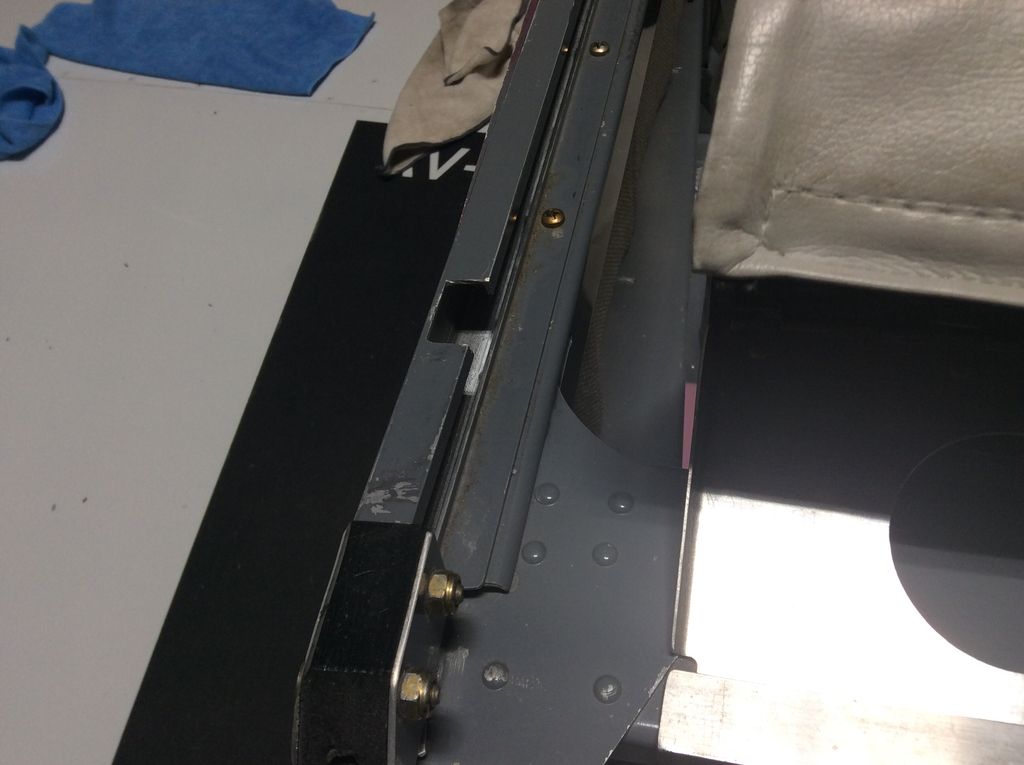

We have two dahon folding bikes and they both fit in our 6. I cut two slots in the aft end of the canopy rails about 3" forward of the aft end. This lets me lift the canopy completely off the airplane with no tool. I don't think I could get the bikes in there otherwise. One of the best, simple mods I made.

Any chance of seeing some pix of your mod?

Default Canopy Removal Mod
I don't know where I found out about this mod, but it is SO useful and easy! I remove the canopy for annual inspection or any other work in the cabin. When we bought our bikes, I simply lifted the canopy off the airplane and set it in the grass at the edge of the ramp while I loaded bikes. I can easily remove and reinstall by myself, but if you have a helper it makes it easier.
The notches are just large enough to clear the roller wheels on the frame and forward of the rear stop by 2.5" this is just so you can open the canopy full open and it can't lift off by itself. To remove, slide canopy to the rollers in line with notches and lift them up and slide back and rest the rollers on TOP of the tracks. It will sit there by itself, but is now loose at the front. Now grab by the from frame and rear slider block, lift the front a bit, slide aft until the slider block is free and lift away from the airframe.
There must be others that have done this mod?
