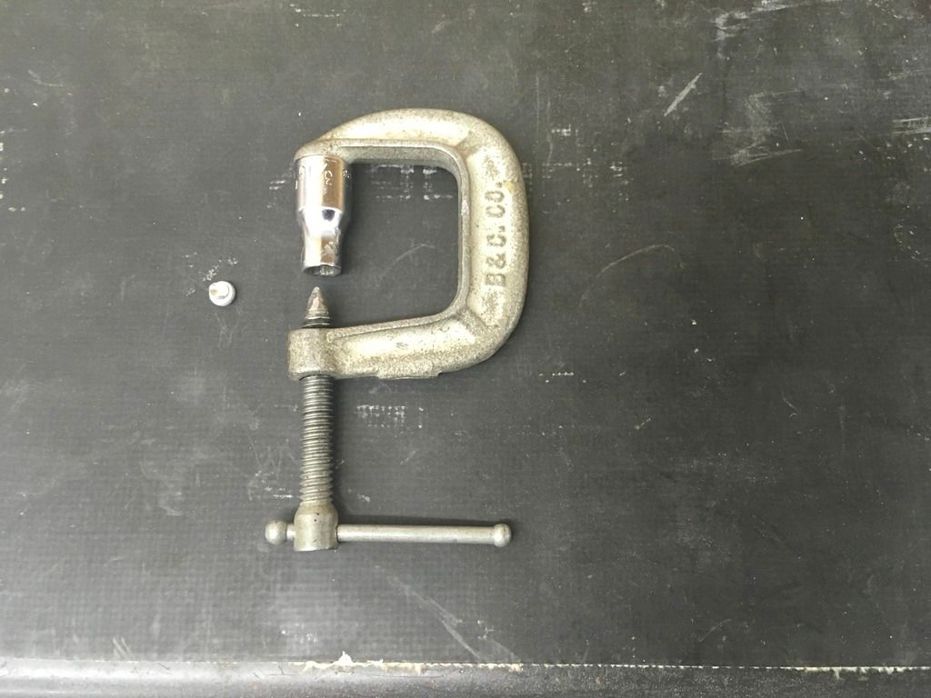

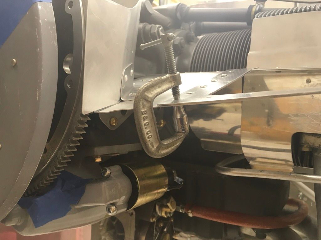

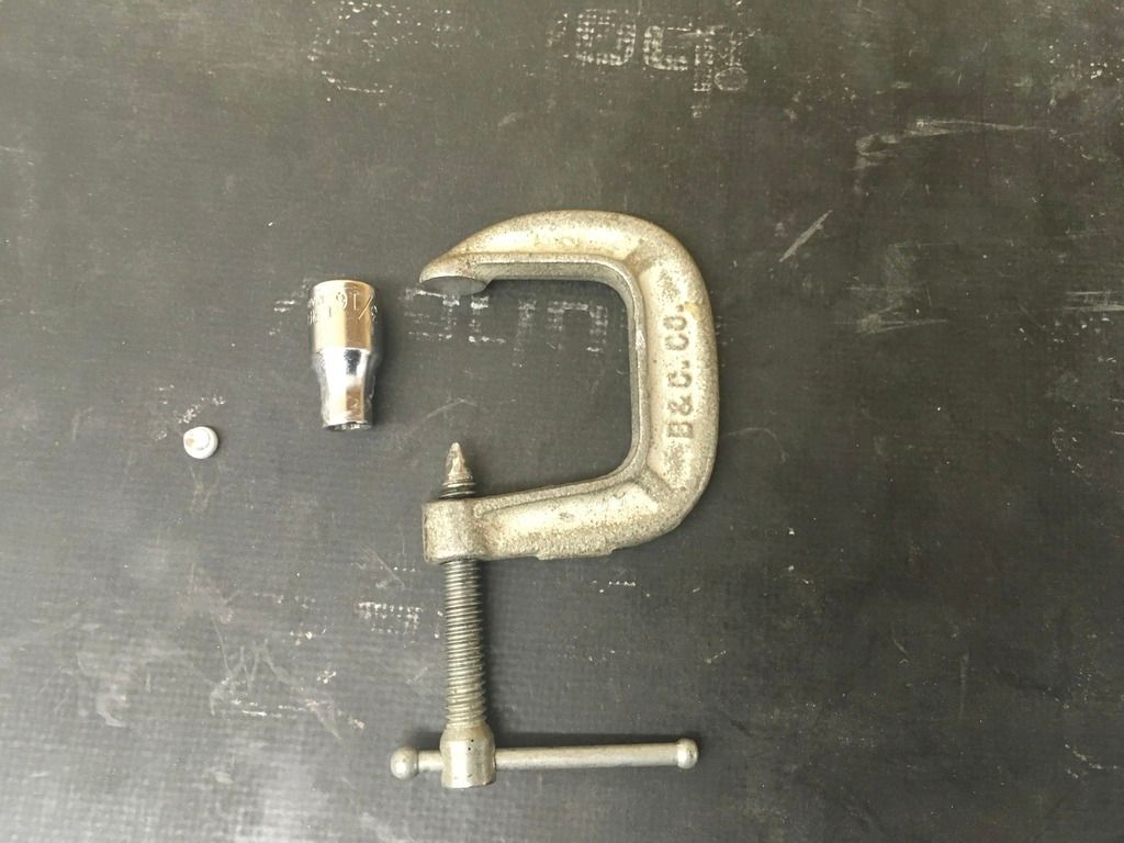

Old 04-02-2017, 08:56 PM
TomRV8 TomRV8 is offline
Join Date: Feb 2005
Location: San Antonio, Texas
Posts: 84
Default Rivet remover 'tool'
This works well with rivets needing to be removed close to an edge. I had the swivel head on one of my 1" clamps disappear. I rarely throw anything away, and finally came up with a good use for the dismembered clamp.
I sharpened the end of the screw in shaft. As the pics below show, I used a 1/4" drive 3/16" socket as the backing and receptacle for the shop end of the rivet to be drilled out.
Use the good advice in this thread to drill and remove the manufactured head of the rivet to be removed.
Then simply place the socket over the shop head of the rivet and screw the clamp shaft into the rivet. Works quite easily.
I used it for a while with the socket loose, and manually lined it up with the clamp. I finally broke down and used JB Weld to permanently attach the socket (which I cut shorter for a little more room between the jaws of the clamp)
I also recently discovered that when drilling the manufactured head off the rivet, and part of the head pry's up but not quite all of it, instead of drilling more, I place the tool over it and when screwing down it pops the manufactured head off at the same time as poking the shop head into the socket.
