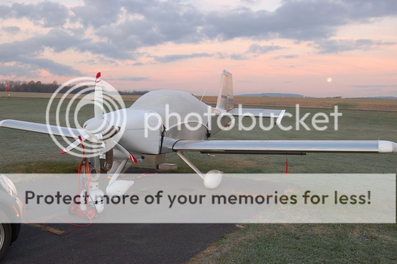

Milk stool heater from Home and Aviation Depot. Dryer duct kit to port the air properly,
I set it up running when I leave the hangar if I think there is a chance I will fly in the next few days.
Serves double duty as a small area heater when I don't feel like breaking out the 300,000 Btu propane torpedo heater.
