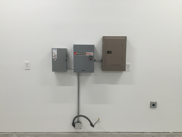

As I have a little time waiting on the weather at Petit Jean this evening, how about a shop update. We have Power! Wow, what a difference to be able to put away the long extension cord from the house. After paint and being able to terminate all of the branch circuits I hooked up the service entry from the pole. I'm happy to report that I released no blue smoke.
Our first night with power was neat to see the outside lights alive.
Oh, boy, another full weekend to hang and wire the 16 interior LED light fixtures. My fingers still hurt.
But there was light!! All indications so far are that my engineering was just about right. It is a little less light than the last shop but still plenty. We've been running only half of them most of the time so far .

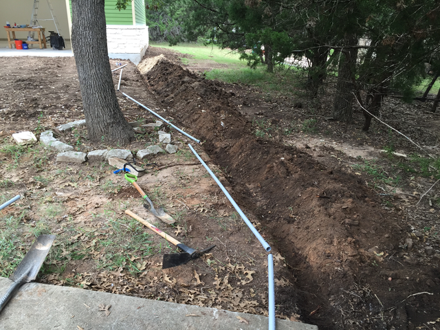

Man, I thought we were done digging trenches? Not so fast Jack. We had stubbed in some conduit in the foundation and wall for some network cable to the house "some day". Well, today was "some day". There is nothing like having a hard line.

This whole project taught me a new skill. I can take a 2.5" down to a 3/4" piece of PVC and turn it into a wet noodle to make it any shape I want. This is conduit for CAT-6.
"Ok, Tanya, cover it back up! Don't hit the propane line."
100' in one weekend takes two days with the tractor. The results are to be expected.

Got my 3-phase panel stuff wired up. There will be an idler sitting on the floor hooked up to those wires.

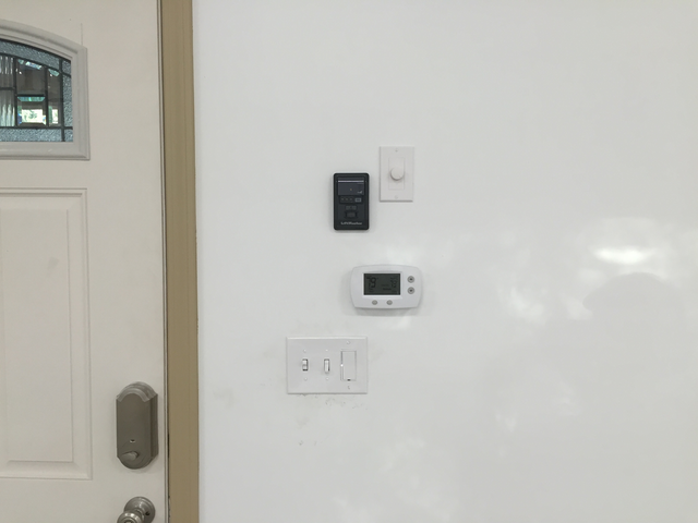

This is my version of thumbing my nose at proper order and design.
We finally have completed HVAC! It only took three weeks.
