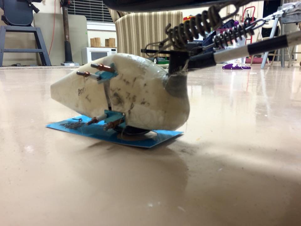

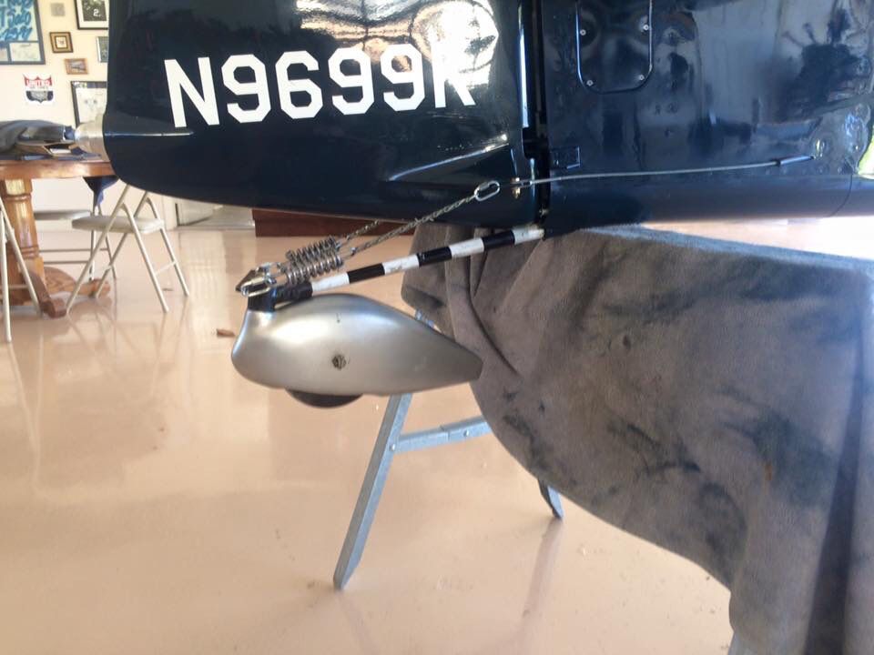

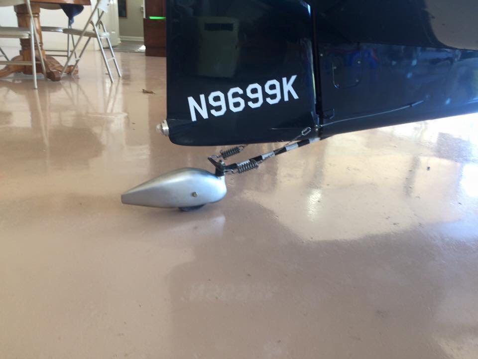

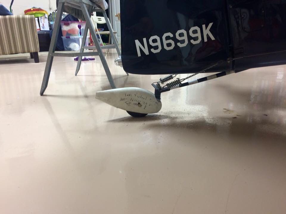

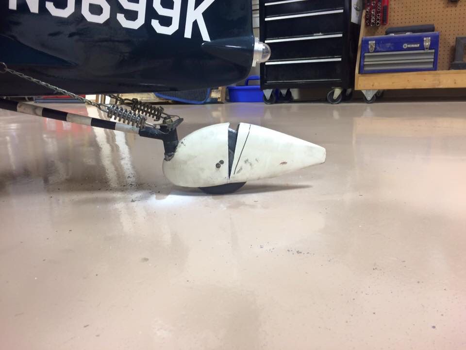

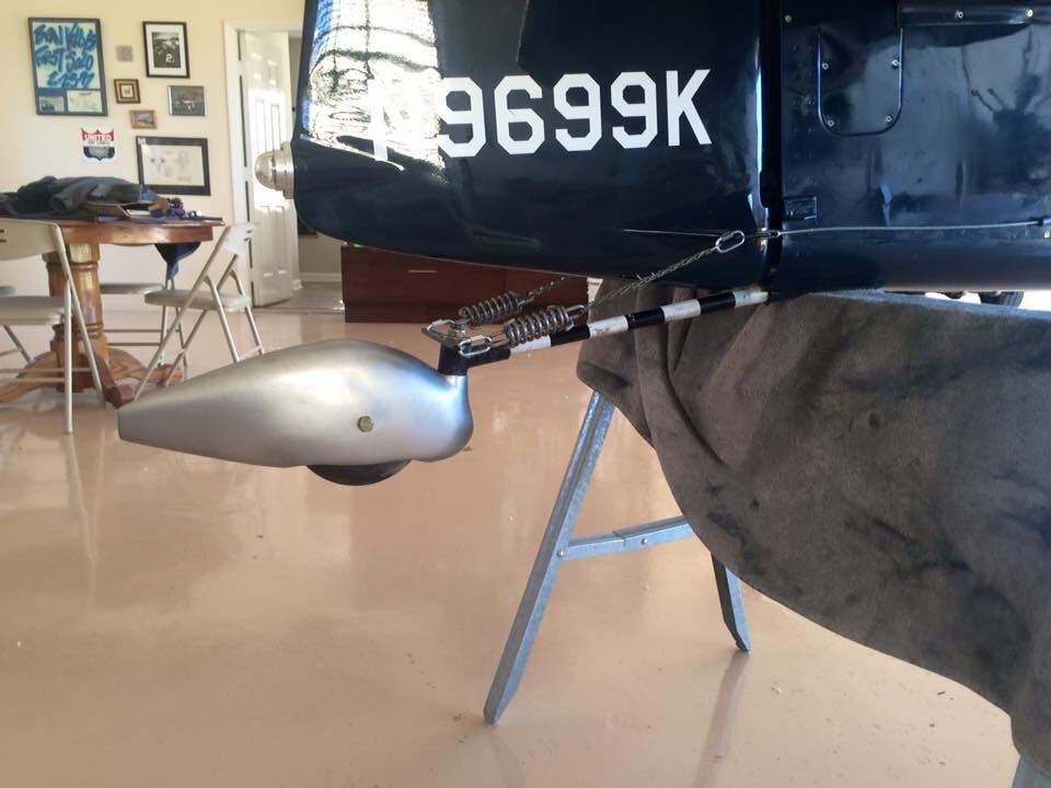

Great work! I ended up modifying a vans tailwheel fairing to work in a full swivel with their stock fork. Yours will be MUCH lighter.

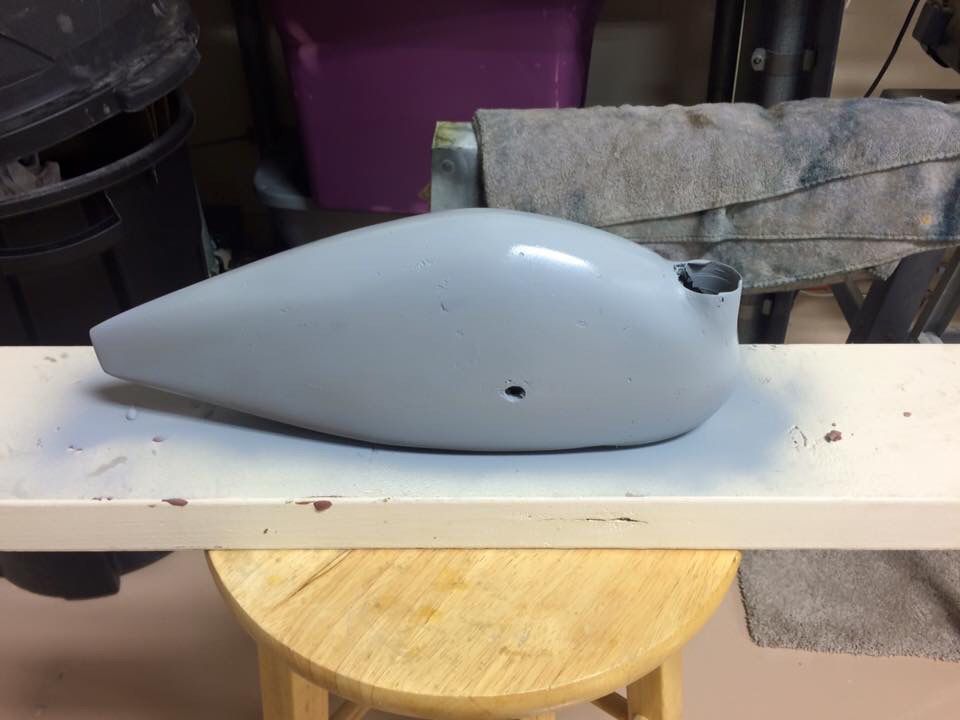

Hallo Vince,
I used DevCad software. Took the original Tailwheel Vans Fairing (one side) and with a Contour Gauge Duplicator, a pencil and a day of winter snow I drew the contour on a paper and measure it to create a DevCad model.

Hi Pat,
I spent a lot of brainstorming and scraping in front of these yours pictures last winter when I started this project.
I'm a big fan of Vince products so in my 8 I installed the Screaming Eagle Retrofit Tailwheel Fork with the Lightweight Tailwheel Tire from april 2014.
You can see it in this thread : http://www.vansairforce.com/communit...d.php?t=111868 post #8.

Hallo,
no laser but an homemade pantograph cutter connected to the DevCad software.

Default 3D Evolution
After a lot of sanding and bonding process I decided that 3D Printer could be a better (and modern) idea. So I jump into the learning process to 3D design with a cheap software (Devfus); here first results, the general idea is to create a negative model with a 3D Printer.
Stay tuned, I'll keep you updated
