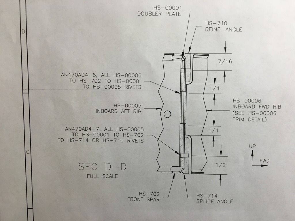

The drawing calls for AD4 rivets in the locations discussed, but the instructions say to drill #40 holes in the last checked item and the first unchecked item. These are from 6-3 referring to the HS drawings.
Shouldn't we be match drilling #30 here? I don't see anywhere in the instructions later before riveting to upsize from #40 to #30.

here are is where the rivets go, I don't know how the original HS is built now, this was a drill apart and add forward spar stiffeners. O ya, there is a top and bottom to these stiffeners, take out your calipers and measure.

I did indeed install my HS-0001 upside down and match drilled that way into HS 710 and HS 714. The holes aren't straight along those pieces, but they have the 2xd edge distances required, and I sent a pic to Vans and they said I am OK. From now on anything that looks symmetrical, I will measure and double check. It was on the plans, but didn't notice "up" till afterwards.
