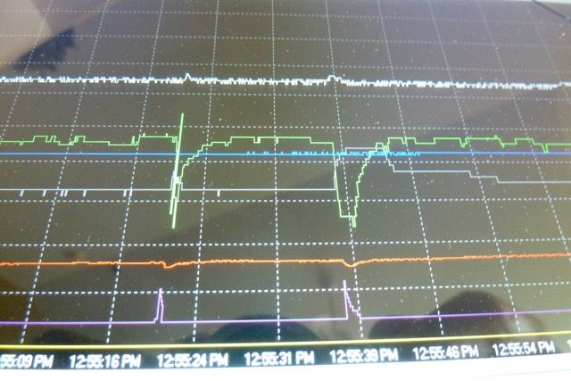

Default Using PC Data Logging Feature
Dave has been trying to sort out an intermittent fault which appears to be related to a TPS issue. He's now using the EM-5 PC data logging option to look at what's happening during the flight. This option allows the user to look at, store and print ECU data to aid tuning and diagnostics.
Here's a screen shot from Dave:
You can see a spike in the TPS reading (grey trace) and resulting changes in injector duty cycle (purple trace) and AFR (green trace).
We suspect an internal TPS problem. Dave is not using our standard throttle body and TPS that we supply with our kits. He sourced his own 65MM Ford TB and Ford TPS since it was felt that larger size might better support his increased power Lycon modded engine.
The data logging feature often allows us to quickly pinpoint customer tuning or running issues. The files are small and can be emailed to us for playback.
Turbo Subaru EJ22, SDS EFI, Marcotte M-300, IVO, Shorai- RV6A C-GVZX flying from CYBW since 2003- 441.0 hrs. on the Hobbs,
