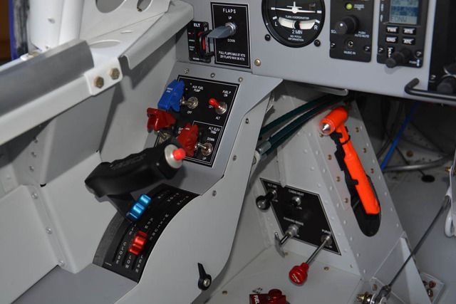

I'm thinking about panel layout for my -8, and one of the areas I am most interested in is the throttle quadrant layout. I've poured through many of the panel layouts from everybody over in its own thread.
I know that the standard issue throttle layout is that basic flat side piece that runs up underneath the panel. It's fine I suppose, and perhaps might be easier for forearm comfort. I am interested though in some of the configurations where I've seen both left and right side panels angle up and meet the bottom of the instrument panel. The throttle quadrant is incorporated into such fabrications and they look great! Very sharp looking!
My question is about the ergonomics of such configurations. How comfortable and/or practical are these different installations. Would anybody have done things differently one way or another if given the chance?

Jeff,
I have short arms (T-Rex syndrome) so the standard position seemed too far for me. Here's the link to the web page showing what I did. I think it is what you were describing as the ones that angle up. http://www.kit-plane-advice.com/aircraft-throttle.html
Very pleased, it made resting my hand on the throttle during cruise or aero very comfortable.

Thanks for the ideas guys. Yes, that angled one was the type I was referring to, the way it angles up to the bottom of the dash. It just plain looks sharp. My issue will probably be my long arms!
I also like the look of that curved throttle quadrant. That could be a real player for me...

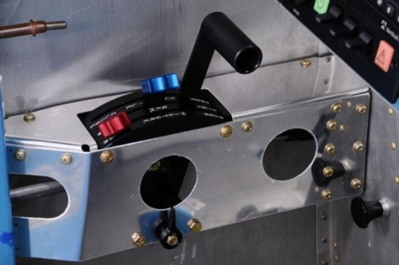

Here is how I did mine.
The throttle is a little to the rear and inside compared to the plans. When I was sitting in a -8 I just looked where my throttle hand falls and here I installed it on my plane.
Today I flew with a 220 lbs tall guy in the rear and realized that I was touching his knees with my left elbow when my hand was on the throttle. Not all that bad but the throttle could be a little bit more forward. I assume that I seldom fly with tall guys like him - after all we have to accept compromises in airplanes.
