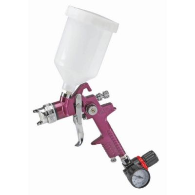

Regarding Jetflex WR:
1.) Any suggestions as to where to purchase it?
2.) What type of gun to spray it with?

1.) Try http://www.aircraftpaintsupply.com in Chillicothe, OH
bought mine over the phone from Sherwin-Williams Aero distrib in SoCal, showed up at my door in two days. Water based, NO hazmat fee.
2.) Harbor Freight SKU 69705, the one with the regulator included
3.) This Kind, from Lowe's, Menard's or equivalent honey-do generator store...
4.) Like Majuro15 mentioned in a previous post, also get a desiccant in-line dryer, which is also from your favorite local home Homestuff warehouse, same as the mask. Air supply obviously needs to be clean and dry.
