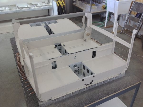

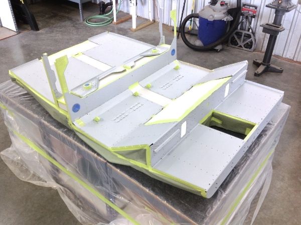

I was in the same quandary when the time came and I did the same thing?got on the jungle telegraph and asked around. I heard from two or three trusted sources that they?d had excellent results with the Jet Flex WR, applied with a very inexpensive HVLP gun from Harbor Freight. Bruce Hill on this forum was the first. I had precisely zero experience with a real live spray gun and was hesitant to go that way, well?let?s make that ?terrified.?
The other option I was considering was the same you mentioned, SEM spray cans. I primed quite a bit using the SEM self-etching primer. Results were top notch but the cost was breathtaking. That paint is about $17 per can and it used a lot. So what?s a mother to do? The cost factor pushed me to give the gun a try ? or should I say give it a shot? (Sorry ?bout that.)
I bought the Jet Flex from SW in San Diego and the exact model number gun (69705) from my local HF for 30 bucks cheap, and opted to try it on some test pieces first. I tweaked the adjustments and the spray distance until I found what seemed to be the best combination, then shot some scrap flaperon skins and the underside of one of the baggage floors. About 20 minutes later when the paint was completely flashed off, I was delighted to behold that it looked as perfect as any pro could do it. I went ahead and did the whole interior floor and sidewall bulkhead assembly based on the test result. It was that good. That gun and that paint really work. I couldn?t be happier (and more relieved).
The finished job turned out every bit as good as the test pieces. No runs, no drips, no errors. Just follow the directions that come with the paint and the directions for the gun. Shoot with everything within the recommended temperature range. Keep the gun moving, equidistant from the work surface and at right angles to it. Overlap the passes about 50%. If your air is dry and the parts and the painting environment are clean ? I mean really clean ? expect success.
One observation: After I had finished the test pieces, I was at first convinced I had blown it completely. One of the worst orange peel jobs ever was lying there mocking me to scorn. Must?ve had some or all of the adjustments and techniques wrong. But then, as the paint started to flash it flowed out and laid right down beautifully.
This is supposed to be about education and recreation. I?d say jump in and get both. Happy airplane building.
