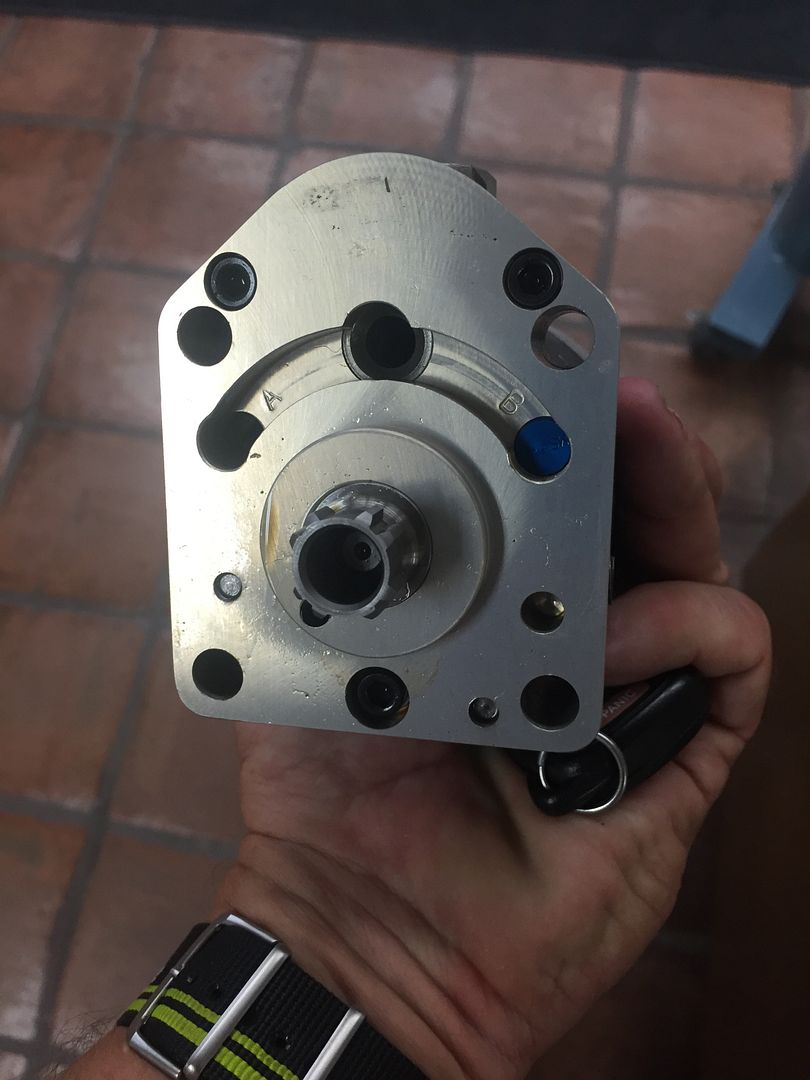

This is the back of a current generation Hartzell PG.
The process for converting the ratio between wide deck and narrow deck involves moving the plug between hole A and hole B,
and then adjusting the clocking and Max RPM.

Neat. Where'd you get the info on converting the Hartzell from wide to narrow deck configuration? I'd like to look in to this some more.

The cited specs are for the given model number.
Kevin, the same guy you spoke with, is also the same guy who told me that they can be reconfigured to different specs. He is the one who told me about changing which hole the plug is in. That was confirmed to me by Ottosen's propellor who are an authorized Hartzell repair shop and distributor.
From a manufacturing standpoint, it make total sense. You want to design and build core elements as universal as possible with allowances for modifications as necessary.
If you don't have a PG, it makes sense to buy what you need out of the box, but that doesn't mean that you can't convert what you need from what you already have.
As an extreme example, some unique part number codes merely differentiate the color of the paint.
