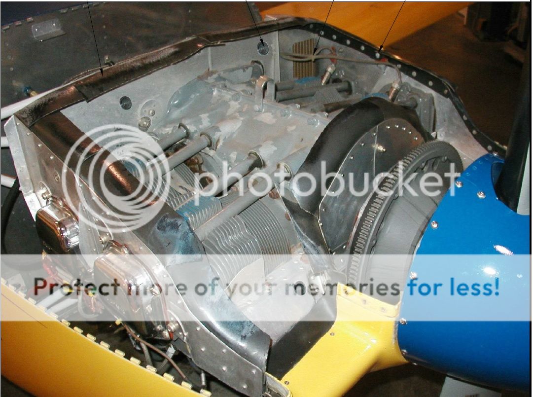

Great idea! I really had to do a lot of head scratching to even guess where the rubber parts go around the flywheel area and around the outer parts of the cowl air cooling inlets.
Not putting this out as "good" but this is Vans RV-7 picture for the O-360 baffle kit instructions.

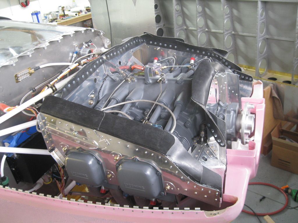

Maybe we're a humble lot How about pics of some pretty darn good baffles??

Or even some marked up "I wish I had done this " pictures?
