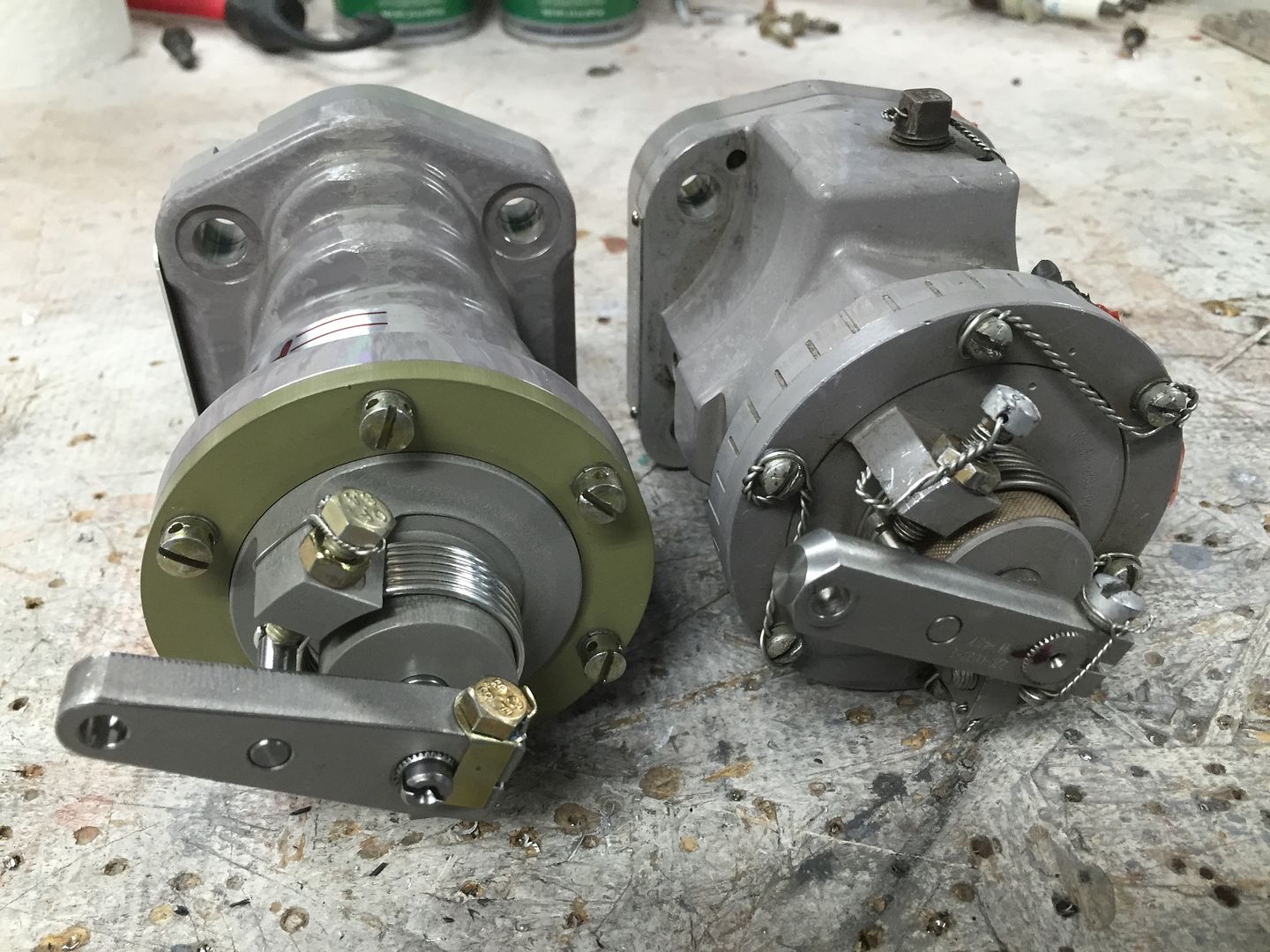

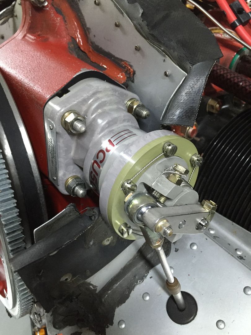

I thought I would post a couple of pictures of the PCU5000X installation, replacing the MT P-860-3 on my WD Lycoming.
It is truly plug and play, only having to adjust the clocking, which is a matter of cutting the safety wire on the 6 screws, adjusting it where you want it, then re-tightening the screws and adding safety wire. No baffling modifications.

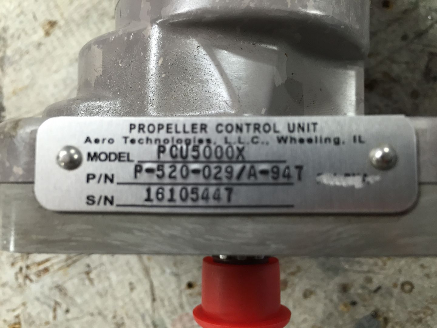

Here is the correct part number (I'm posting it here because I initially received the wrong Hartzell and PCU5000X).
Here they are side-by-side, MT on the right:
Here it is mounted:
I ordered the PCU5000X before I found out my MT is not affected. Mine was built in 2008 and was overhauled 100 hours ago, so if someone wants it let me know. I will let it go for $600 plus shipping CONUS.
