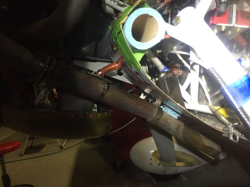

I thought you might be making some custom couplers from the inlet rings to your diffusers, wheel pant galoshes are on my list somewhere....
True!
It's on the list, first is data and evaluation of the current design, then consider a change. I really like the idea, but Gotta Get Flying!

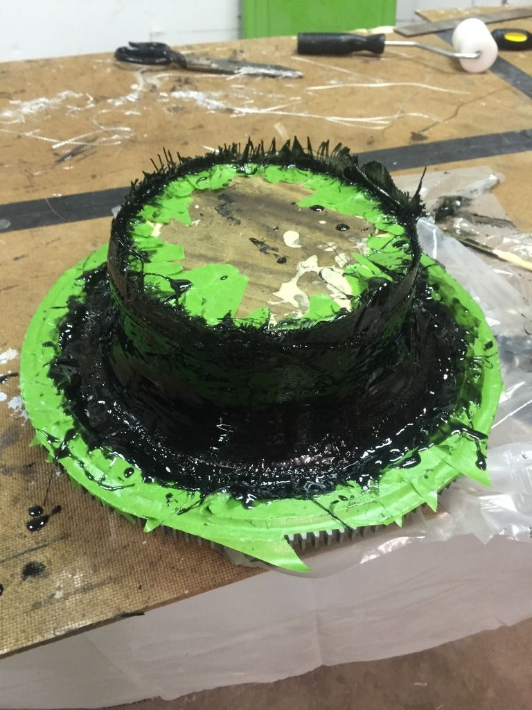

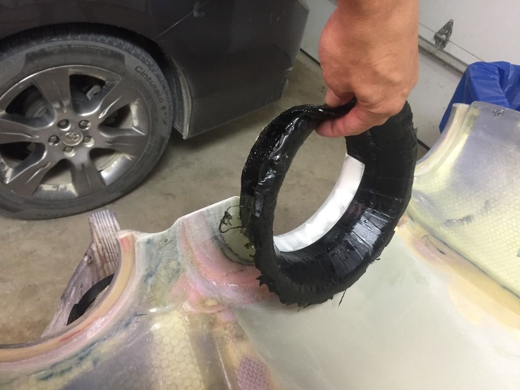

The rubber mostly cured overnight, I really like using the plastic HDPE material for molds because the rubber/epoxy peels right off
I think DanH's aluminum ring insert is a better design, we'll see how the boot sticks to the inlet lip over time. It would be a slightly harder layup but I think I could make it a one piece layup next time. For now more progress, things seem to be fitting well.

I made another "plug" to simulate the reinforcement ring of the inlet duct out of the same HDPE I've used for the rest of the project. I made the radius 1/16" larger than the inlet ring to give me some wiggle room, after I sanded things smooth it was probably more like 1/32 larger. Since the cowl split line doesn't bisect the center of the circle I also squared the sides of the HDPE plug tangential to the half circle (not sure how else to word it) so the top cowl can slide over the top of the inlet duct reinforcement rings.
I paired the new HDPE plug up with one I previously made for the inlet rings bonded to the cowl. The center hole used by the circle jig in the router makes a handy centering pin.
I was originally going to layup over the rubber ducts, but the diffuser shape was in the way to do a decent glass job. I clamped in the HDPE plugs and epoxy/floxed around the ring and glassed over the top.
After some sanding the joggle is looking pretty good.
The smidge larger depth worked out well, I had to do some sanding on the thickness to get things sliding in and out properly. I may shim my plug slightly wider for the next 3 joggles. The inlet ring/duct fits pretty well.

As I think you know, several of us are using a converging exit duct of significant length. Recent photos show a shorter duct on a certain famous RV-4. Smart aero guys have told me anything much more than a few inches is a waste, as velocity changes in a near-instant fashion at the point of pressure change. In the latter case, the short radius is just to get rid of sharp edges at the exit.
The long duct question seems to be that any theoretical velocity increase may be offset by additional skin friction.
You already have several experiments going. Given the above question, why not go back to flying, get some solid measurements, then add the larger duct later? That way, any subsequent performance change (good or bad) can be attributed to the duct.

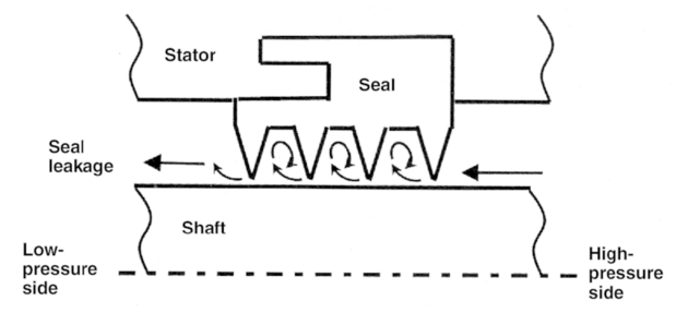

foam seal
I've never seen foam used on a cowl like this for sealing the propeller shaft. What about heat build up on the shaft from rubbing the foam? Seems like you would want to minimize that. What about shaping a really low density foam to have teeth like a labyrinth seal to minimize contact but still providing a seal? or just eliminating the foam, you have a low diameter gap which is good and will minimize leakage.
Interesting.......
Yes, I plan on flight testing 1 change at a time. Just trying to start visualizing my next move.
Good ideas Steve!
Honestly I won't be too surprised if the foam removes itself in one fashion or another, but on the other hand I think it has a chance at working. I'm anticipating the foam to "wear" into shape rather quickly, I should know after the first test run. If it does create too much friction I could modify the seal as you suggested.
My other thought would be to glass in a flange around the spinner to parallel the landoll ring and use baffling material from the flange to the outside of the landoll ring.
I'm not sure I've closed the gap at all, any air escaping still has to exit the 3/16th gap between the spinner and the front of the cowling. I'm not sure making the hole smaller upstream from the spinner gap changes the amount of leakage or not.
