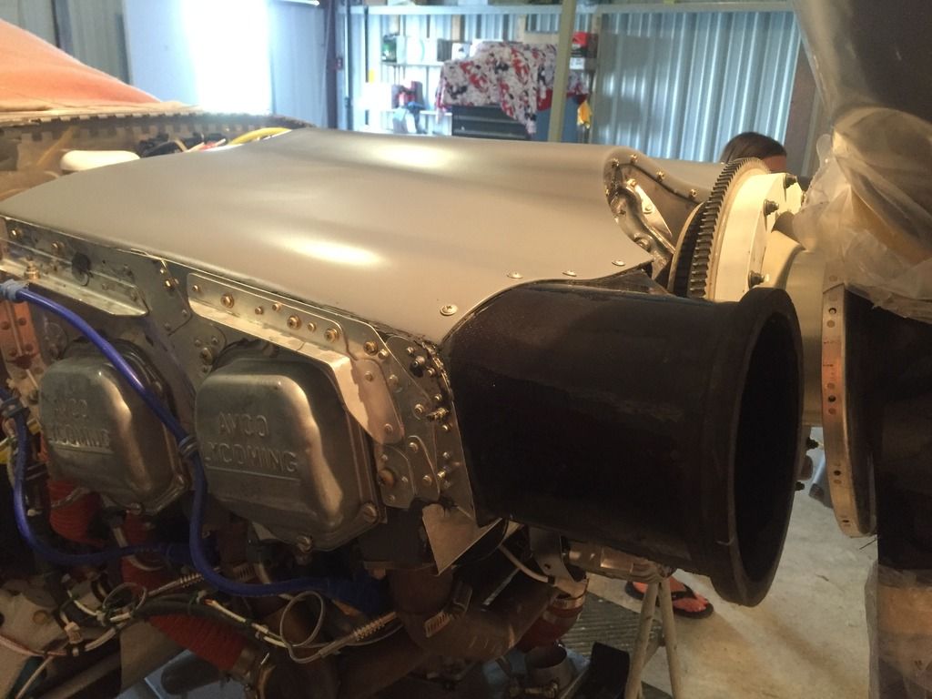

I sealed the intake boots with RTV, my sticky test showed Ultra Black doesn't stick the best to the rubber but I think it'll hold and come apart relatively easily. If it doesn't seal, weatherstrip adhesive sticks really well to the rubber but I'm not sure about withstanding the heat. My aluminum clamping strips on the inside of the boots seemed to work well.
All sealed up (I hope) and ready to button up the last couple items on the annual and see how the round inlets/boot diffusers/plenum work together. I used some NAS1802-8/32 Phillips hex head screws on the plenum, I liked the option of drill driver or socket or a wrench for the hard to get to spots.

I'm just wrapping up the annual and it's time for some engine runs and see how the new boots/cowling work together. It fired right up and ran like it should. The first run was just in the idle/fast idle range for about a minute. After shutdown I had some smoke exiting the inlets and behind the spinner and once I opened it the oil door. It didn't smell like a fuel/oil/electrical smoke but I still got the cowl off in a hurry. I found a light dusting of pink foam dust on the components of the lower cowl, I think that along with dust/mouse milk on exhaust joints/LPS overspray was causing the light smoke.
Pie helping me with the first engine start, as you can see she's feeling like her old self with plenty of spunk.
Good news is I was picking up 8 inches of water pressure in the upper plenum from the prop blast at 0knts and full power (966 AGL, Baro 29.94 and 94*F) , I'm still looking for my previous notes on the stock setup. Bad news is the right intake boot started de-laminating. While inspecting the boots after a full power run-up a little poking around caused the boot to separate from the front ring, The left side boot looks fine. If you recall I laid up the rubber boot first and then molded the front reinforcement ring onto the boot with some urethane adhesive, this is the joint that is coming apart. I did remove the right boot from the mold early (maybe 12 hours into 48 hour cure) so I could get the left boot in the mold, I'm wondering if the twisting/pulling it out of the mold before full cure attributed to it coming apart.
More prodding and picking revealed the epoxy flox reinforcement ring underneath.
I think I'm going to make a single piece layup on the right intake boot/reinforcement ring and see what happens.
