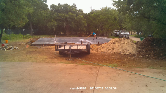

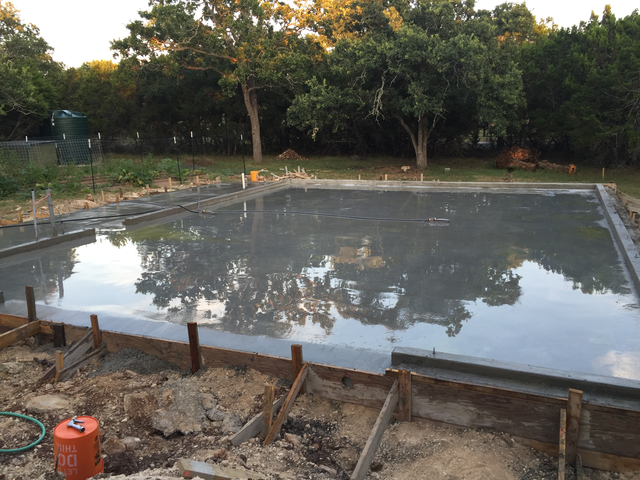

Boy, it has been a full time job babysitting this thing for the first couple of days. We have three sprinklers on it. The unfortunate part is that we couldn't find a hose timer that you could set more often than every hour. That just isn't cutting it during the heat of the day so we're on a 20min watering schedule to manually trigger the timers for a few minutes of watering. I could have planned better and setup a couple of sprinkler control valves triggered by a Pi or something.
The foundation guy says we're "over the hump" now, but we're still keeping water on it today. No cracks yet (knocking on wood). The pi cam caught an intruder with a squeegee scraping off some of the surface scum at 6:30am this morning while I slept. The rest of the forms will be pulled tomorrow. Happy 4th!!

Scott, it may be the water hiding them, but I didn't see any control cuts in the slab. That is about the only way to keep cracks from happening. Concrete will crack - either on a control crack line or wherever it wants. With the steel you have in the slab, you won't have any up and down so don't worry too much about cracks. Looking good!
Edit - zooming in on the steel photo, it looks like they may have divided the slab with expansion joints. It is a bit hard to see but looks like your contractor knew what he was doing.

There aren't any control cuts or expansion joints. This foundation is almost completely independent of what the soil does. I'll deal with some simple shrinkage cracks if we have to, but the idea of cuts to catch all kinds of stuff over the years sounds like a bummer. The contractor was ok, but the real expert was/is our structural engineer. He does big commercial jobs with my company and is a real expert. Contractor: "Wow, I've never seen this in residential construction. Size and amount of rebar, depth of piers into rock, size of grade beams, ..." (Scott smiles) I told the engineer (an old hippie that has more commercial work than he can accept due to his local status) what I wanted. "Like a fine custom home, or a bullet proof commercial building. I think we got it. Those statements came from the fact that our house foundation absolutely sucks, and now I know why.
