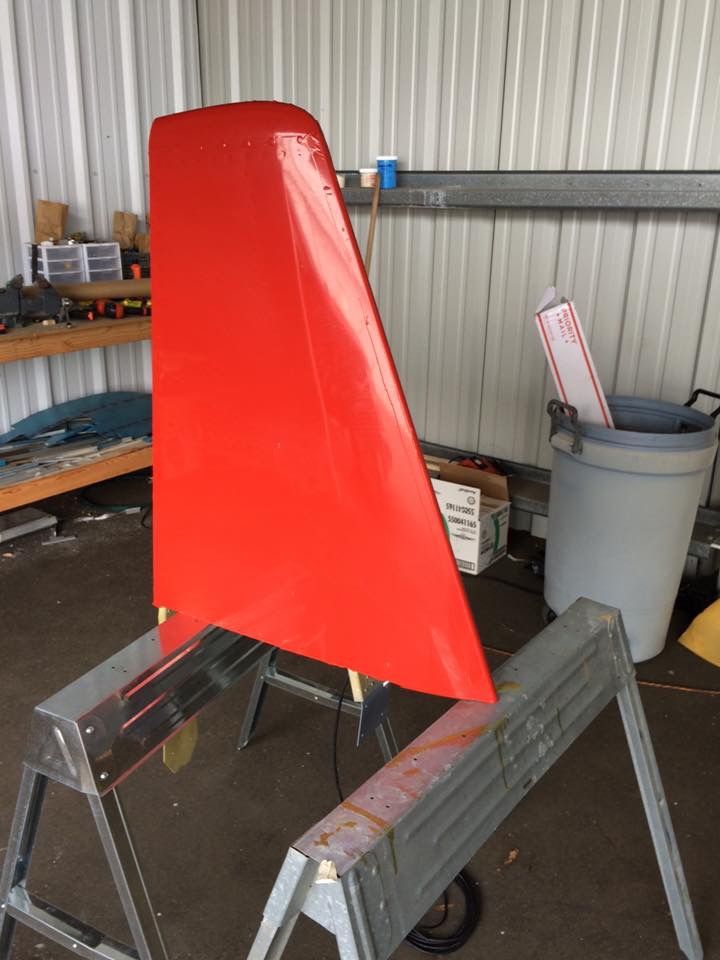

Old 10-03-2016, 03:56 PM
AcroSmoke's Avatar
AcroSmoke AcroSmoke is offline
Join Date: Nov 2013
Location: Albuquerque, New Mexico
Posts: 31
My experimenting with vinyl. Thought I would start with the horizontal and vertical, see how well it goes befor any major covering or control surface removal.
It is a learning curve bet so far myvinyal skills are much better than my painting skills.

Nice job - the latest eaa experimenter has a feature on vinyl wrapping that convinced me to give it a try soon as well.

Posts: 1,412
I attended the Reno Air Races this year, and at the RV barbecue on Saturday, I met Jay, an RV-10 builder who vinyl wrapped his plane (by himself!). I asked about removing it, like if you did a poor job, or later when it's old or you want to change it. He said removing vinyl from bare aluminum is substantially easier than removing it from paint over the aluminum.
